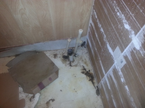

There is a metal pipe coming out of the floor that the wall-mounted sink used to attach to, but the sink fell off the wall and the pipe broke. I don't think it is currently attached to anything. In the laundry room there are three plastic pipes sticking out of the floor. Two of them have shutoff valves and one of them is capped. The east wall has a small window in the laundry room. There is also a small window in the bathroom. There is a small ceiling fan in the laundry room as well as a vent to the central air conditioning.
I don't think that the wall the appliances rest against is load bearing.
I'm thinking of tearing out the walls of the bathroom, getting rid of the useless shower (which is currently being used as a storage closet), moving the washer and dryer to the east wall or south wall, putting in a sink to rinse clothes in and having a stall for a toilet using either a shower curtain for a doorway or a bifold door or an accordion door. I don't think there is enough room to have a sink and toilet in the same little room and still have decent space for the laundry area. Given the market for houses in this area, we aren't terribly concerned with losing value in the home by eliminating a bathroom. The current bathroom is not anywhere near up to code anyway. I wish I could figure out how to keep a small shower in the area somehow too. Perhaps it could be used to rinse with a detachable shower head or something-- but again, more walls= less space.

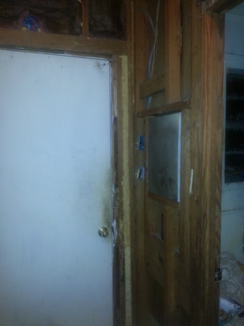

There is a light above the exterior door (the wiring is inside but the light is for the outside). We currently have a curtain hanging in the doorway to the kitchen because the entire laundry area is not properly insulated and is cold in winter and hot in summer. The wooden floor near the door got wet somehow and expanded we tried putting those styrofoam wrapped in cloth things under the door but it just snagged on the linoleum and tore it and then ended up getting stuck and making it hard to open and close the door.

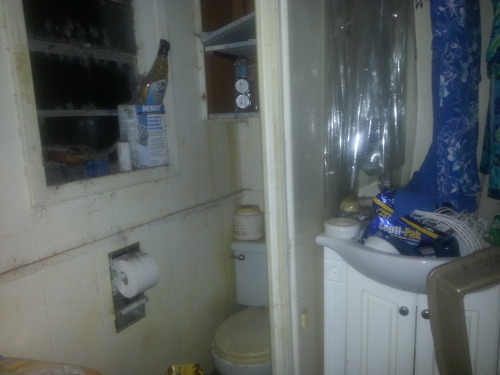

FWIW, the toilet installation does not meet current code which requires a MINIMUM of 15" either side of the center for a toilet install. Where you have a toilet, you must have a sink nearby to meet code, too. Now, a laundry sink may qualify - you'd have to check with the local inspector. Many washer/dryer pairs have optional stacking brackets, which may help with the space problem. I agree with HJ, I'd consider moving them to the west wall - they should fit with a little room to spare. In most cases, the WM hose is long enough, but the dryer duct may be more of an issue, but not insurmountable.

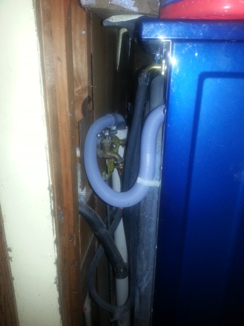

The plumbing to supply water for the washer and dryer is on the north (lower) wall and sticks out about 5 inches. This makes the washer and dryer stick out even more. The combined width of washer and dryer of pushed tight together would be about 54". The east (left) wall has the window (which is slightly below the height of the washer/dryer) and the vent for the dryer is also on that wall. IIRC, my mother said that the reason she didn't want both units on that wall was bc there was no room to open the doors since the wall is a little less than 61". The doors are rather thick and won't swing very far (because of the stuff on the South wall that sticks out and makes things have to bump over more to the North wall by 4" to 5"). Just moving the washer and dryer in to the space in the first place was a major ordeal in the first place.

Just before the entrance to the actual laundry area is a door frame. I've determined that the wall is not load bearing (one since it is so small and two because it runs parallel to the joists- the load-bearing beam in the kitchen is perpendicular to it).

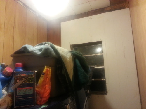

From the South wall to the window = 18". The window is just shy of 23" wide.

Jadnashua, yeah, I realized it wasn't to code. I think I griped about it elsewhere before. LOL. The distance from the toilet to the old sink probably wasn't to code either. I doubt that much of anything in this house is up to code. I know it has been around since at least the 40s and there were some renovations in the 60s or 70s.

Other notes: The window in the laundry room is just under 23"wide and is 18" from the south wall. The bathroom has no lighting and is being used as a storage closet so I didn't get the window measurement there. That window in particular is home to spiders. The whole room is probably a spider nest by now actually. The measurements are approximate since I am not very handy with a measuring tape and I have trouble seeing the smaller lines. If it isn't .25 or .5 or right on the mark of a main number I have trouble seeing it.

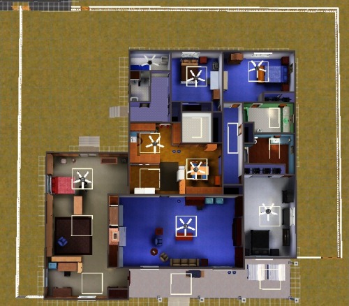

Here is a rough floor plan I sketched of the house. Blue marks the bathtubs, toilets, and sinks. There are two bathroom sinks and a kitchen sink as well as three toilets and two bath tubs. I do not know where or if the useless bathroom's sink and shower are tied in or not.
I somehow suspect the house is not vented properly. At least we have vents now. When we came back from overseas the tenants had ripped out all of the vents and screwed up our water lines.
Out of curiosity, what would be the proper sizes, order, and distances for these vent pipes? Is it normal to have so few and of such small size?
