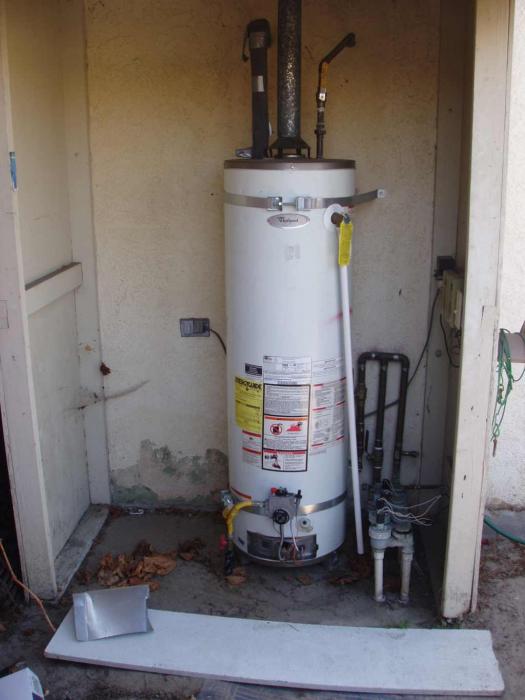

Well I have a FuWaHe (guess what this is!) whorfool in a house I bought august 2008. I have tenants there and since it was like 100 degrees last week, not that bad, but I had the SAME CRAP happen same old rigamarole pilot refuses to stay on, so I get the bangalore and go to highs, (oops I mean LOWS) get the 'D' box, install it and I was ELATED it functioned for FIFTEEN MINUTES!!!!! now the same damned crap again. I will use ALL of the suggestions before I replace the gas valve. I got a gas valve from LOWS and I hope I can return it. I will stare in the window to see the flame hitting the thermocouple, thoroughly clear out the vent. (I sort of did that already), bend the thermocouple closer to the flame, and even minimally increase the size of the pilot hole. After that I will replace the gas valve, and if it is still crap, I will go to HD and get a GE. My house had a FuWaHe about 8 years ago. Brand was HOYT I think like 20 years old and I received NIAGARA FALLS from the bottom. I then got a GE from HD and it has been good ever since, did not have to light the pilot even once after initial lighting. I had a bunch of other crap like replace galv with copper etc.
One other thing that I noticed is when I installed this assembly, the burner attached to the old assembly had no nut to hold it, just 2 screws on the bottom. I will need to dig for the nut, or was it ignored since the beginning?. I also wonder where I can get another nut (if there was one there). Does the nut have special gas flow wormholes in it?
I am wondering what to name if WHORFOOL is my name, I have seen CESSPOOL WHIRLPOO. I have a WHORFOOL washer now I am SCARED it is like 6 years old (knock on wood). It is good that the house with the WHORFOOL is only 4.5 miles from me in Anaheim (I am in Buena Park).
If I need to replace, I WILL remove it and carefully put it in front of LOW*S front door, take a pic and then quickly depart.
I don't know which LOW*S it was purchased at because I got it with the house (how sad). BTW model number ends with NOV so it is the older one.
I also remember seeing here a post calling it WATER HOLDER, that is basically what it is!
FuWaHe FuWaHe

sept 8
OMGOMGOMGOMGOMG I do not know if the DENIZEN OF LUCK has arrived yet, or if it will FUBARIZE again, but what I did was BEYOND BELIEF but I had only enough TIEM to watch the water get pseudo hot. THE PILOT STAYED ON for one time so far it did not dump, the water got hot. I DECREASED THE GAS FLOW THROUGH THE MAIN VALVE!!!!!!!!!! OMGOMGOMG
I also (WITH GAS ON FULL) WATCHED THE MAIN FLAME IGNITE, and FLAMES SHOOT THROUGH the alleged 'flame arrestor' (you needed to brush it)
one more time, I WATCHED FLAMES SHOOT THROUGH THE GRILL OUT OF THE BOTTOM ONTO THE WOODEN BASE. So I put an 8" square aluminum plate underneath there.
I put the gas valve close to being OFF, the main flame was about 50% of when gas on. I am aware it will require more time for the water to get hot, but AFAIK that will not be a problem until 3 billion people simultaneously take showers. It's 40 gallon.
I just went outside and stared at the GE and yupp same damn unitrol crap, but the 3 lines go STRAIGHT DOWN into the combustion chamber, not all curlicue like the WHORFOOL!!
yes, I inherited this POS just like you did.
and yes, I also inherited this POS from the previous homeowner. My 6 year old or so GE is still flawless so far
Well, I don't know if I drained enough water, like maybe 2 gallons, but water was pissing out of the pressure relief pipe and it arbidumped again. Isn't there a shutoff valve on the inlet??? I am conjecturing that the gass valve refused to shut off when it got hot. I have another new gas valve that I guess I will have to replace tomorrow 4 miles drive again not happy with exxon stock. I just set it to off and the tenants have one tank of hot water for a few showers. I guess I will screw with it tomorrow it is 4 miles away from me so no one will get to retire with their exxon stock. I also am aware that when you remove the gas valve, the water will all gloog out unless you MT the tank.
As for the flames shooting through, I should camcorder it and start a PROPER class action suit, like getting the dictators of these DUMPANIES in JAIL
I will post the pic of my car rear window with WIRPOOL WATER HEATERS SUCK sign attached......
update sep 9
Well I got the new gas valve in. THE OLD ONE REFUSED TO SHUT OFF so the water BOILED and then it dumped. I HAD TO BASH THE WATER HOLDER shell to get the new one to fit. THE THERMOCOUPLE DICK sticking out had a shorter threaded rod, but I got it in and I observed the temperature get up and the burner dumped without the pilot dumping, SFSG!!!11 one one. I do not trust it yet, however.

Well it has been 2 days so far. This is what I did to accomplish this feat of impossibility. First, I removed the window and installed OLD steel (I think) screen folded into 3 layers and wedged into the old glass tabs. Second I did the bend on the thermocouple to get it JUST ABOVE the pilot. I speculated that the burner flame messes with the pilot and makes it go higher. Third I REDUCED THE GAS with the main valve. After this, I watched it operate 3 cycles and today (2 days later) I jingled the tenant and was informed 'the tiny torch flame is still there behind the screens'.
I even put the hot water on to drain the tank and watch 3 cycles successfully.
And here is my dose of sarcasm.
The stupid arrester screen that allows flames to go through has apertures that ate TOO TINY to allow oxygen molecules (O2) to go through so it all goes through the window converted into a screen thing (The pilot appeared healthier after the modification)
And yupp, I had to piss all the water out with a garden hose B4 replacing the gas valve. The gas valve has the wires built in and a forward threaded insert so no more weird adapter. I now need to beg for luck on an astronomically gargantuan basis! I hope that I produced an EPIC WIN that I kicked the WHORFOOL's HINEY

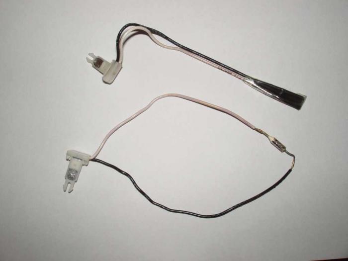

Quote:
Originally Posted by hussy250f View Post
I bought a Whirlpool Flamelock, LPG , 1 year ago from Lowes. The old B.W. blew a leak late on a Saturday, Lowes is nearby, blah blah blah. This new one went out about 3 weeks ago.
To shorten this post up I'll say that the thermocouple is fine, checked with a multimeter during lightup, and I have a clean flash arrestor in the bottom of the unit. I also checked for voltage before and after the "circuit breaker" located below and to the right of the gas valve, 22mv in (black wire), 19mv out (white wire).
Lowes did not have a LPG valve in stock, and most of the local plumbing supply places only carried the normal "I could care less" looks.
I called the # on the water heater, got them to send me a new gas valve, under warranty, so no cost to me. The new valve would not be in for a few days because this took place on a Friday. So I pulled the gas valve out of my old B.W. water heater, all the connections lined up and she fired right up even with the old thermocouple in place.
All I had to do was adjust the burner pressure down a bit to eliminate the slight yellow flickers off the ends of the burner flames, the yellow was not present when the Flamelock was in operation before this.
This past weekend I pulled apart the original Flamelock gas valve to see how the pilot circuit is setup. I found out that the white wire from the "circuit breaker" runs up into the temperature sensing element that protrudes into the tank and thru what I figure is a thermistor that must cut off the pilot circuit at some really high water temperature.
I'm figuring the thermistor breaks down internally over time and the pilot won't stay lit. When I get the time I'm going to try and rig up a test stand to put a controlled
heat source on the temperature sensing probe of the gas valve and see if the mv signal to the pilot circuit drops after a bunch of on / off cycles.
I would have to say the the problem I am diagnosing is centered in the RobertShaw gas valve and not the flash arrestor like some people here are saying. When I first started to lose the pilot, upon restart the burner would light right up and burn all blue flames, no yellow at all, stay "burner on" all thru a heat up cycle, shut off and then I could see the pilot slowly lose gas till it also died. I'm pretty sure if the main burner can work at all the pilot will not be starved for air between heat cycles, so pulling out the glass or drilling some holes in the unit won't help.
I don't know if the new gas valve has any changes from my original, but they do look identical. That would explain why the "upgrade" kits seem to have the same problem down the road. The thermistor in the temperature sensing tube would be the quick fix AWH and RobertShaw came up with to replace the left hand threaded thermocouple on the early models.I think I saw in a picture somewhere that left hand thermocouple had a bulge in the tubing back a bit from the coupling head.
Maybe if an AWH or RobertShaw employee is going thru this pile of post they can look into this.
And no, I still have not changed to the new gas valve.
I might just remove the sensing tube first to see if they changed that thermistor to a different spec part. Shes' still working fine with old B.W. gas valve.

Smile Flame Lock Whirpool Water Heater model NO.?
I have purchased already 3 Whirlpool Flame Lock water heaters from Habitat. These were donated to Habitat for sale by Lowe's, obviously warranty returns with problems. All 3 had removed model and serial numbers so I do not know what models I have. To order parts I need model numbers, otherwise Whirlpool can't locate the replacement parts. Can anyone help me using the pictures below to identify the model? The thermocouple has right-hand threads and manifold tube also right-hand threads. The water heater is similar to what Lowe's has on the floor now, but my does not have the Thermal switch.
When purchased the problem was not thermocouple but the high temperature sensor (HTS) in all 3 cases. That is an internal part (penny value) and I suppose the whole thermostat (gas control valve) needs to be replaced. In first instance I got around by taking the HTS from the 20 year old water heater I was replacing. Second and third time I took it from new similar valves that I happened to find at Habitat and bought it cheaply. These HTS are very easy to replace, problem is to get it. If someone knows where to buy it I will appreciate the information. See the last picture below that shows 2 HTS, one as removed from the gas valve and one with insulation stripped. It would be very easy replaced (silver solder) if the electronic component was available to buy. I do not have the problem with clogged screens. One water heater is installed outside as shown on the picture, one in my garage elevated above the floor 18”. Also I need outer doors for both. My email jfkn@cox.net.

Talking you are in trouble
that is a new one on me,,,, I have never seen this new peice of junk bdefore
this is not a flame lock water heater.....
that burner assembly is some sort of
energy star type that is close to the same radiant burner assembly that BRADFORD has is their new energy star models..
I cant immagine how bad these must be considering they cant make a normal water heater work corretly..
LOWES dontated some real junk to
habitat for humanity and should be held accountable... being the fact that they scraped off the model numbers and serial numbers should tell you what kind of crap you got there....
I would tell them you to take them back and "dontate " a better water heater to those homes....or you are going to the local news papers.
