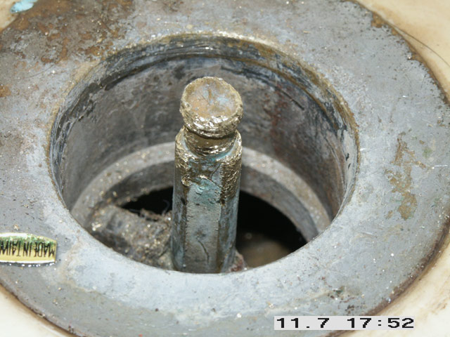

I'm stuck. I can't find a tool that can actually work with the drain on my bathtub. The problem is that it has a post in the middle that's about 3/8" longer than the cavity inside the dumbbell wrenches I've bought so far from Home Depot, Lowes and Harbor Freight. I can't cut it off, because it doesn't stick out above the drain far enough to use a hacksaw.
I tried Plan B & used a cheap pair of pliers to stick a handle end down each side of the drain, then used a pipe wrench to try turning them. The only thing THAT achieved was a bent, now useless, pair of pliers. :(
I *can* turn the post by gripping it hard with pliers and rotating it clockwise or counterclockwise, but it doesn't seem to do anything besides rotate... it doesn't loosen, it doesn't tighten, and doesn't end up any higher or lower.

Update: I managed to cut off the offending 3/8" so the dumbbell wrench from Home Depot now mostly fits. Unfortunately, I can NOT get it to turn. I had a friend holding the wrench (and pipe wrench being used to turn it) in place, climbed into the tub, and tried shoving the wrench with my heel (kind of like doing squats at the gym). Somehow, I managed to visibly bend the cast iron pipe wrench handle, and almost kicked my friend in the face when my foot slipped... the drain? It doesn't appear to have moved at all.
Good god. Is it normally this hard to get a drain unscrewed from a tub? The videos on Youtube made it look straightforward and relatively easy... insert the dumbbell wrench, give it a good hard turn or two with a pipe wrench, and the whole thing neatly unscrews & comes out. The only thing stopping me from just trying to pry up the tub and cut it off from underneath is the possibility of cracking the drain pipe beyond the part that gets replaced by the new one anyway.
Also... you turn the drain counter-clockwise to remove it, right? Or are there known to be weird drains that loosen when turned clockwise and tighten when turned counter-clockwise?
If it matters, I think this drain was a twist-up type (the plug itself was gone when I bought the house).
Update: Joy! I got it off. I tried the same approach as last time (sitting in the tub, using my heel to shove the pipe wrench handle like squats at the gym), but instead of my (now justifiably-paranoid) friend, I held it on top pf the drain with my right heel. I thought for sure the handle on the wrench was going to snap... but it worked!

These are removed by going counter clockwise, it's standard threading.
