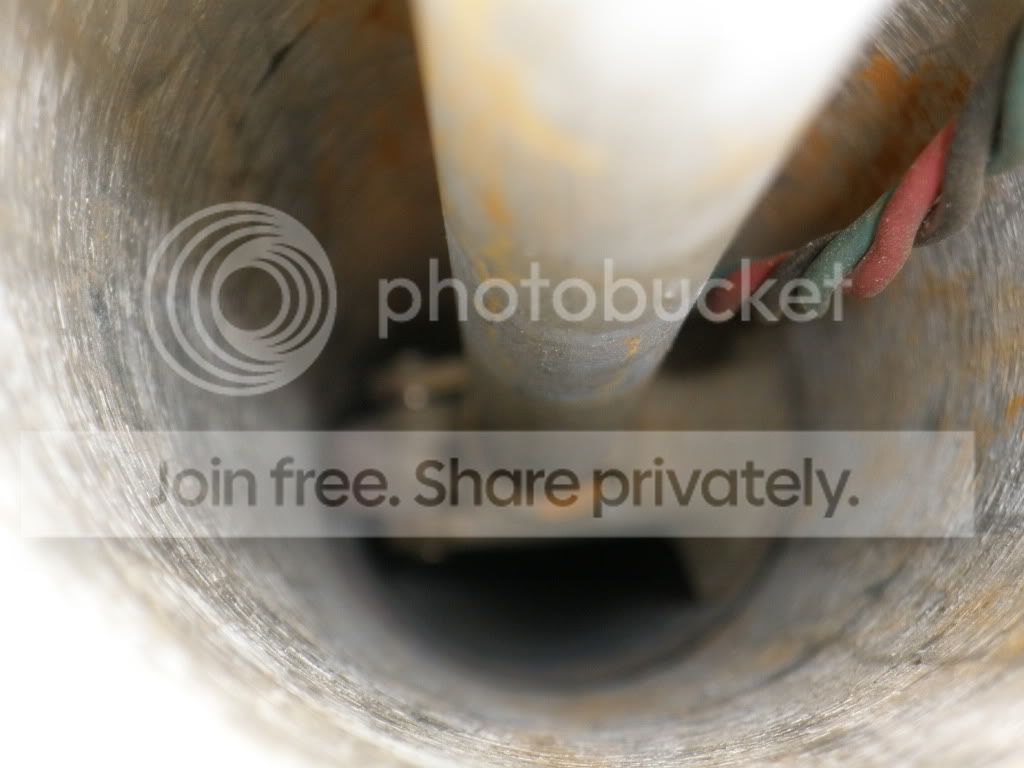

I've got a leak or bad check valve and need to pull up my pump.I've never done this before but last time I had this same problem it cost nearly 2000.00.It was just a rusted nipple but I was told I should opt for a new pump,What a rip.Anyways I couldn't figure out the pitless connection but what I'm looking at online seems as if mine is of the "cable"or "spring" type.There is no cable on it but it has a piviting lever that contacts the side of the well.I pulled and pryed as hard as i could like an idiot until I noticed the lever.I tryed to make a hook out of some old copper tubing that was laying around but no luck.What should I do to unhook this thing? Am I on the right track??The well has been running all summer on 5 sec. off 15 sec. 24/7.I thought this was the case but only verified the problem after a 300.00+ electric bill.Thanks for any help you can offer

The adapter I have looks similar to that drawing.The "actuator" lever doesnt appear to have ever had a cable on it. I've tried everything to get this dang lever to release but I'm not sure if it needs to go up or down.I made a hook and tried every thing I could think of with no luck.Any suggestions?
I don't know if these pictures will help but you can see what I have although blurry
I've used a prybar,tried turning it with a pipewrench,tapping with a hammer while prying.I've tried both lifting and pushing down on the lever but it doesn't move.I'm afraid I'll break it and really be screwed.I've searched the web to try to get a better idea of how its supposed to work but I havent found anything like this piece of crap.

That makes sense, I looked down the inside of the pipe and thought it looked like some sort of screw.How far do I unscrew it and does it allow the lever to go up or down? Do I then need to pry the fitting apart or will it just seperate?Thanks so much for the info.Gary
SWEEEEEEET, Thanks Anna Mae your a life saver.I cant wait to tear it out and fix this leaking system.I was just outside and looked down the pipe and see exactly what your talking about.Thank you very much,Gary
