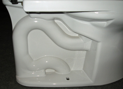

    The Kohler continues to have the tight bends that will "trap" stuff going down.
    The trapway on the Kohler Class Six Cimarron lays flat, hopefully waste makes it through the tight bend for the flange.
    This is where I find the most plugs with the bowl.
    Not a good design.
    The TOTO Drake II trapway points the waste down the drain.

    The MAP test basically measures only one thing. If people look at only that, and the makers design to that test, other things like bowl wash, splashing, noise, are going to get neglected.
    No great mystery, really: If you put most of the water into a siphon jet you can suck down the contents but the bowl won't get washed vey well. If you put most or all of the water into the rim the bowl can get washed but the level will rise before the siphon fills.... If you use a plain washdown design (no siphonic action) you get a different set of tradeoffs.
    It's a matter of balance among different qualities--like most engineering problems. Maybe the MAP test has made it's point about flushing ability and now it's time for a more balanced test that reports several performance parameters?
