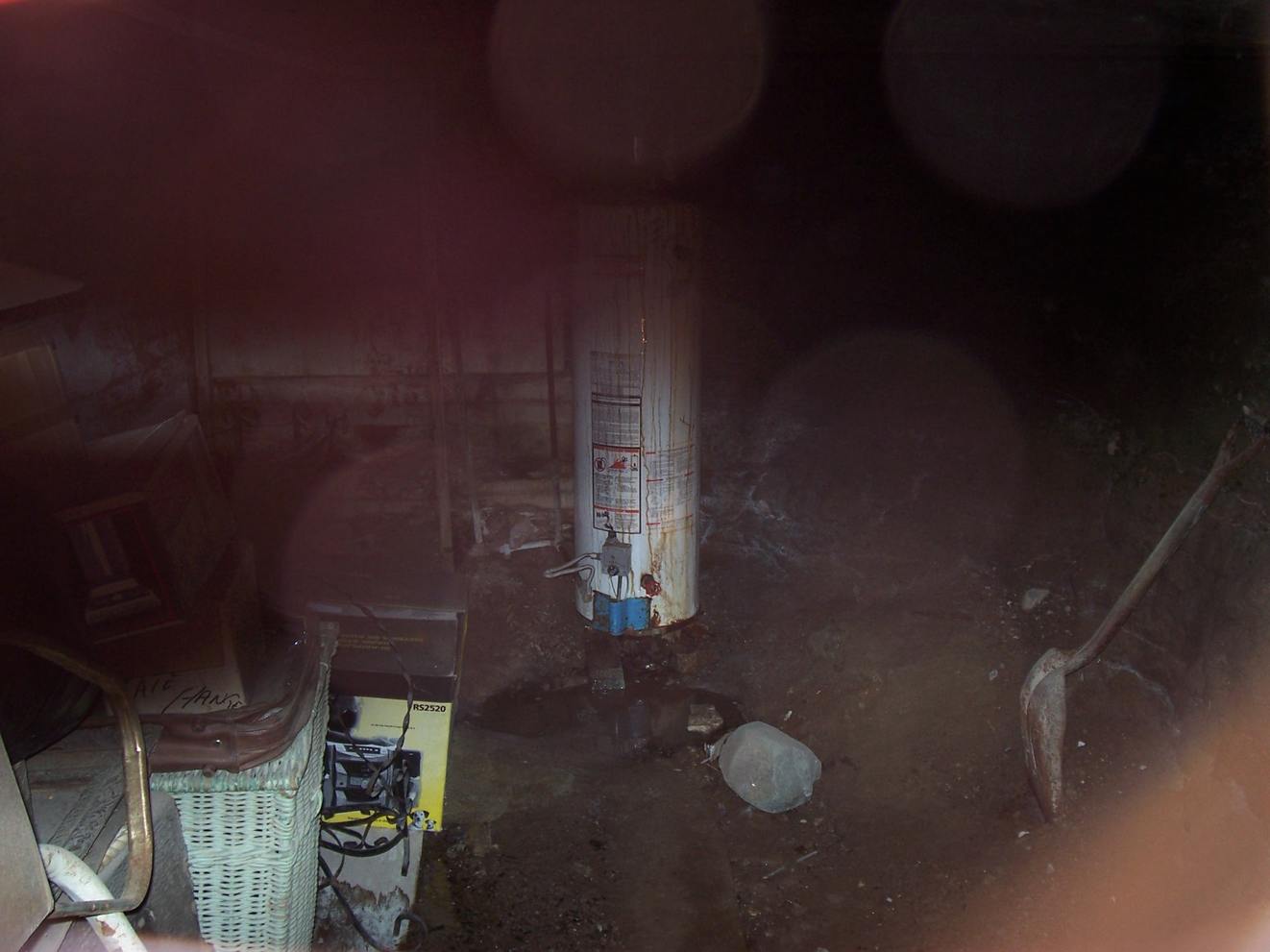

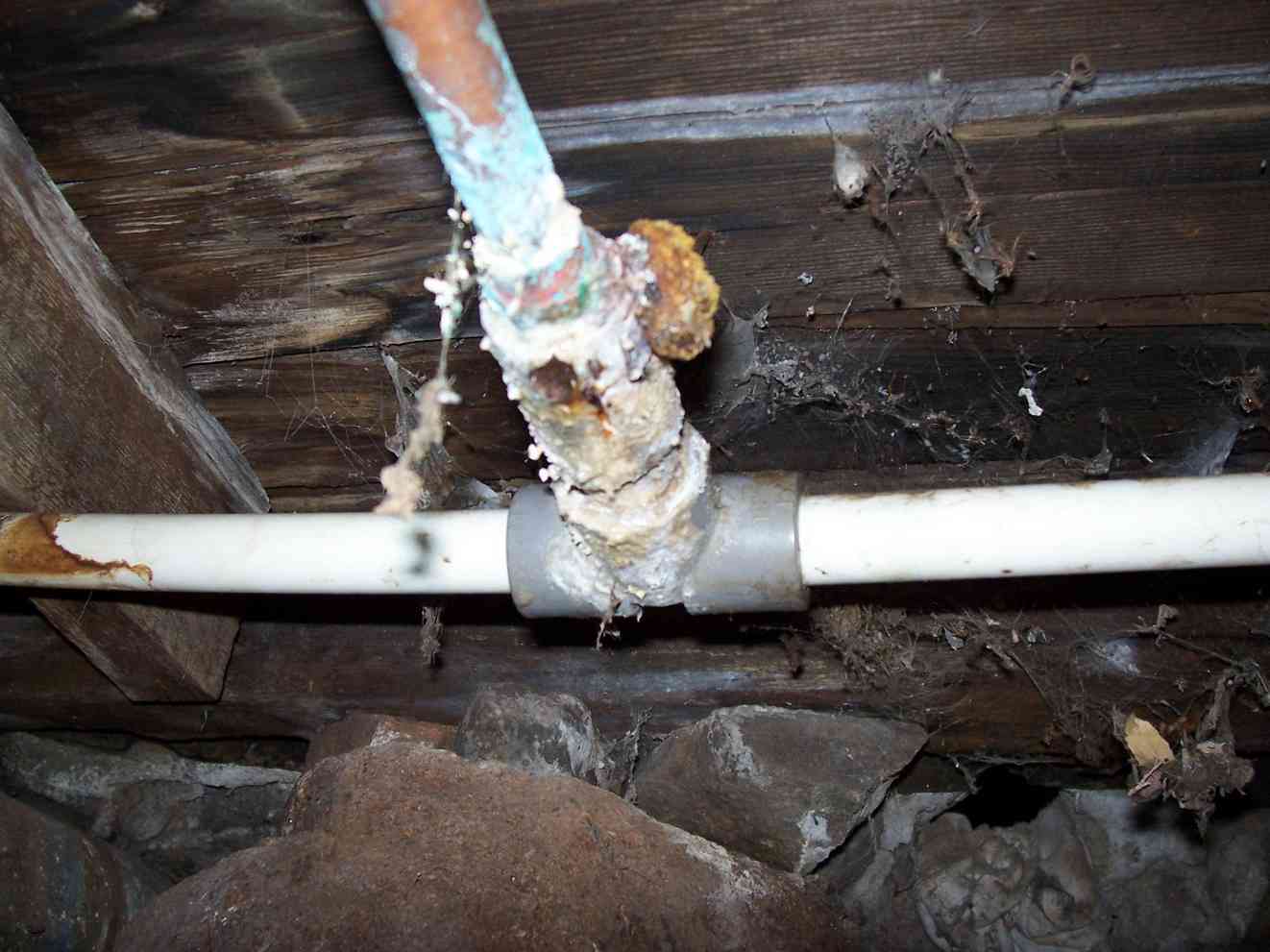

    It's been a while since I installed a HW tank, and this one is a little worrisome. It's below an old home in some sort of cellar. It's been leaking for about a month and has no shutoff valves of any kind. So it's like working in a very wet and muddy cave, and there's no light except what comes in from the one door.
    All the fittings are corroded away to nothing, so I have to do a lot of extra plumbing. For the cold side, I'm thinking of cutting off the bad tee in the main line, which I believe is 3/4" PVC. I can use a compression tee or a cemented-in tee, and then use a CPVC adapter. I'll then install an in-line CPVC ball valve and some more CPVC and finally connect up to the 24" flex copper, which I'll connect to the new water tank.
    For the hot side, I'm thinking of cutting off the bad el and cementing in a new el with a CPVC adapter and use a straight piece of CPVC to the flex copper.
    Questions: Which is better, the compression tee or the cement-in tee? How long do I have to wait for the CPVC joints to set up before pressurizing the system? Is it necessary to have a ball valve on the hot side as well? The CPVC ball valves are only rated to 180 degrees.
    Any other suggestions?

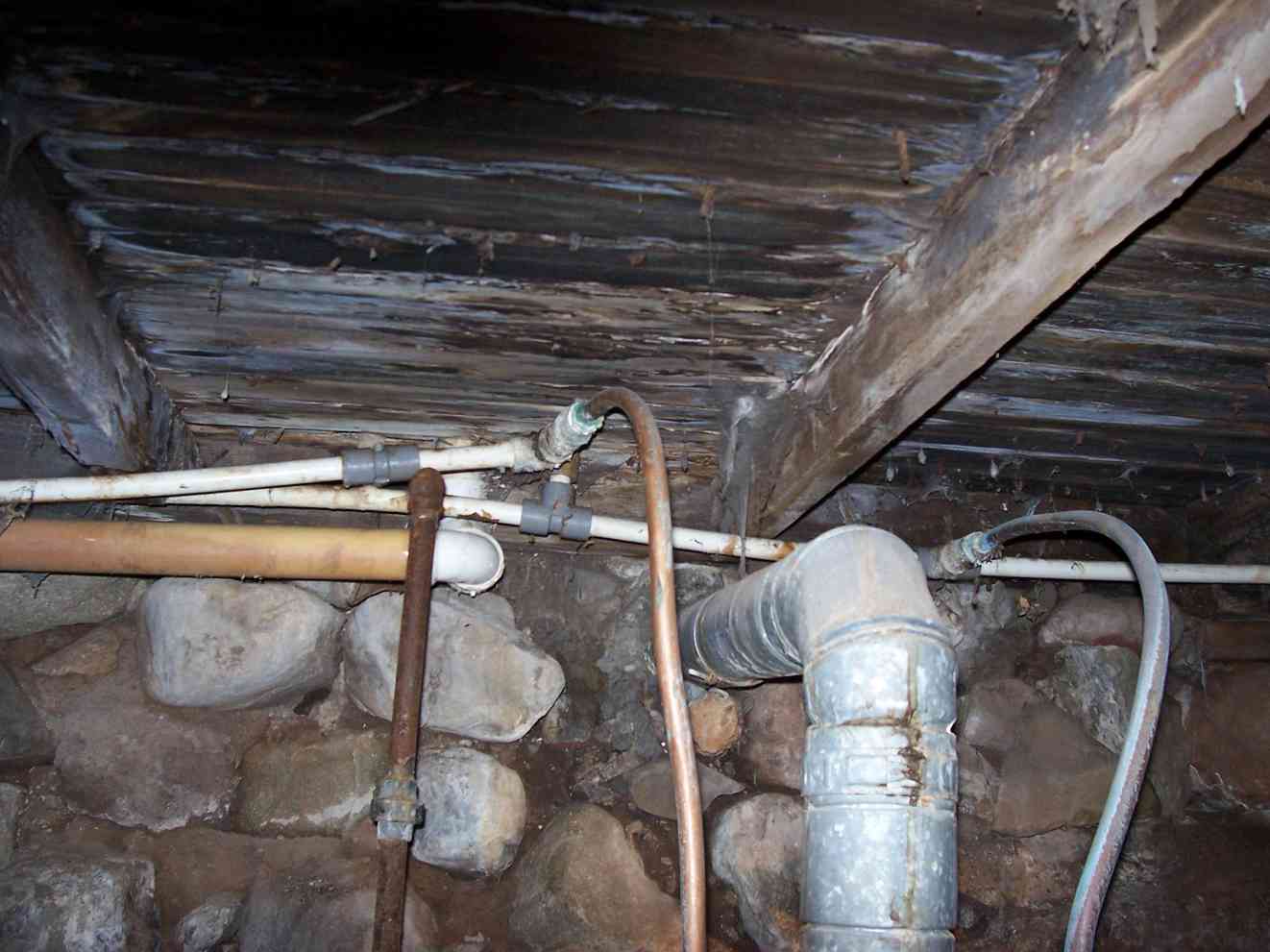

    those are the ones that make you wince
    when you have to tangle with them....
    I would go buy a couple of shark bite 3/4 Tees
    and simply cut out those old nasty ones,
    it looks like you got plenty of loose play in the lines
    then you could run the plumbing to the water heater
    with anything you wished
    a ball valve is always best on the incomming cold side
    and of course on the gas line you want to use a flexible gas supply connecter
    It looks like that old one will probably fall over once you disconnect
    it from the pipes....I would suggest draining it all the way down first...
    have a fun time

    The gas union is on the wrong side of the shutoff. It should be on the heater side of the shutoff and it looks like it is on the street / meter side. All you have to do is switch the places that they are located.

    "A lot of extra plumbing" is a gross understatement if you're going to get this mess straightened out. I'd say it's pretty obvious that this is an install done by someone totally unaware of codes. That pipe is not CPVC, it's PVC and that isn't allowed inside the house. PVC and CPVC are different materials and sizes, so you can just tie one to the other. I question that you can even legally have a gas heater in that location, but certainly if it is to be installed there, it needs a solid slab to set on. At the very least, the entire mess of pipes should be stripped out from the water source forward and properly plumbed. Personally, I'd use copper pipe and a ball valve for the water lines. That will still probably be second rate since the main supply is almost certainly ancient galvanized pipe and really due for replacment, but at least this job should be done as right as possible. You definitely need to see that the gas is correctly connected. I think the very first thing you should do is to check codes to see what, if anything, can be done with this.
    Thanks for all the advice. I keep trying to tell you all that this area is like a third-world country. There's no codes or at least no code enforcement. I know the difference between PVC and CPVC, which is why I'm using only CPVC for my work.
    The homeowner has no money to change over all of her plumbing. It took her a month to get the money to buy the tank, even though water has been pouring out of the bottom the whole time. I'll put on my rubber boots and do the best I can to get her some hot water.

    23,534
    Default water heater

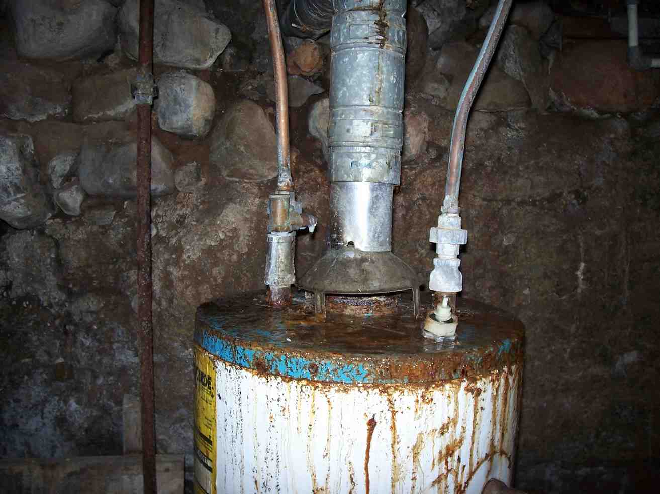

    Third world or not, the laws of physics still apply, so if that is the T&P safety valve in the first picture, replace it before the heater blows up and she doesn't have to worry about the rest of the plumbing.
    Quote Originally Posted by hj
    I don't know what that thing is on top of the tank. The gas was actually turned off by the gas company a few weeks ago, and she hasn't had any hot water since then.
    Today, I cut out the old nasty tee and el, disconnected the gas and the vent, and then let the old tank topple to the ground. The entire bottom just fell out of it, and I just rolled it into a corner.
    The new tank is firmly in place on a bed of bricks. The gas line, the dielectric nipples, and flex copper are all connected up and all the CPVC connections have been cut and dry-fitted.
    VERY IMPORTANT QUESTION: I'm using several plastic screw-in type adapter fittings to go from the 1/2" PVC to the 3/4" CPVC and from the 3/4" flex copper to the 3/4" CPVC. Some of these fittings have a black seal in the middle of them. Some do not. Do I need to use teflon tape or liquid teflon on any or all of these plastic threaded fittings? Or do I just tighten the hell out of them and they will self-seal?
    I sure don't want to go back into that rat hole again once I'm done.

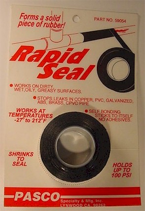

    I'm all done cementing all the slip-on joints and teflon-taping all the screw-in joints. I'm really afraid that one of the cemented joints will leak. The original "plumbers" decided to run their original PVC (yes Gary, it's PVC indoors) under one floor joist and then up a few inches, and then down again under another floor joist. This flexibility might be achieved with a long piece of pipe, but when I cut out the bad section, there was a lot of pressure on the joint I was cementing. There was no play at all in the line, so notching the joist wasn't an option.
    I made almost nothing from this, and I don't want to cut out anything and start over. If that joint leaks, can I use this Pasco product or anything else. I just want a temporary fix, so she can call a plumber if and when she ever gets the money.
    Plumber Cass's Avatar
    Nov 2005
    5,992
    It states it is good up to 100 PSI so it will depend on the water pressure. It is a temp fix anyway and I guess you were just trying to help someone out so use it if you want just let her know about it. Be sure it says it is O.K. to use on PVC
