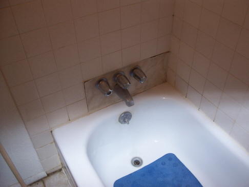

    I get to practice cutting/drilling tile in the shower in my new apartment. As you can see, someone got lazy or just didn't know how to cut around the valve stems and tub spout. They installed some thin laminated board instead, which is already failing.
