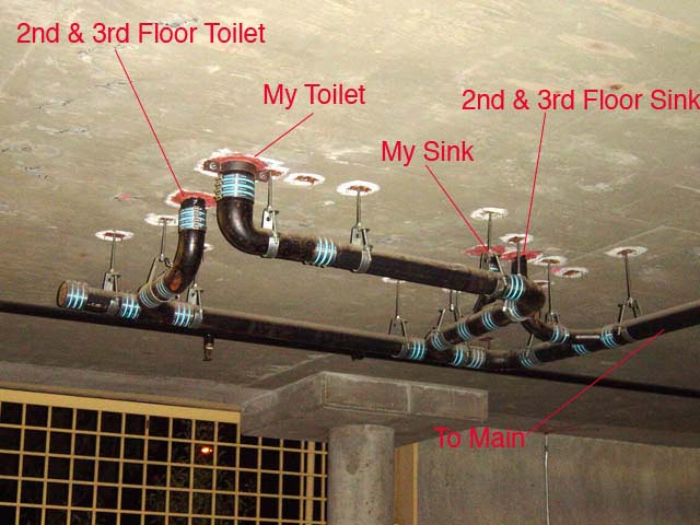

    Default Update
    So They came out to look at my toilet. They went downstairs and opened the pipes to my toilet all the way to the huge main line and found no clog or problem at all.
    I enclosed pictures of the setup underneath.
    The main line (not pictured) looks huge (About 10 inches in diameter) so i assume the clog happened before that.
    Like I said he opened up the lines (pictured) at both ends and could actually see no clog. He also opened up the lines at my Toilet & Sink and found nothing?
    So why on earth is this toilet gurgling?
    Is there another reason for gurgling other than a clog?
  8. #23
    Nov 2005
    Central Florida
    2,504
    Others may know the secret, but it's not terribly obvious to me that there are any vents in that mess of pipes. I'm also not crazy about the circuitous route things take to get to the main drain, especially that 135-degree turn. If you imagine lots of waste from upstairs coming into pic #1's area, it looks like it'd be just as easy to get to your toilet as it is to get to the main drain -- easier, in fact, in spite of the slope. I'd ask them to route your drain directly to the main and isolate your mess of pipes from the upstairs mess of pipes. Finally, when he said he opened up the lines "at both ends", could you maybe show us in the pics exactly where he looked?

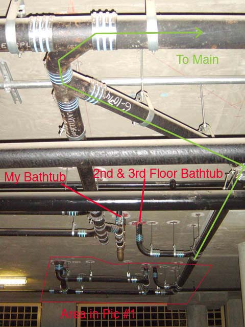

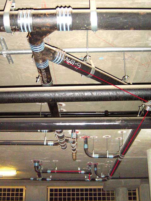

  9. #24
    Quote Originally Posted by Mikey
    In this picture I indicated with red lines, the sections he took off to look.
    5 sections in all.
    You mentioned vents? It should have them or it shouldn't?
  10. #25
    Sorry, forgot the pic.

    I don't think he went far enough -- he stopped right at that hard turn I didn't like. Everything needs to be vented. Since I'm just an amateur plumber, however, I'm going to bow out here and let the pros have a crack at it.

  14. #29
    What did the plumber say about that terrible u-bend where your system connects to the line that goes to the main drain?

    Default I'm going to bow back in...
    ...and suggest that once in a while (I get the impression that this problem only occurs once in a while) a pretty good clog forms at the U-turn that plumber1 and I don't like. When that happens, the pipe backs up slowly as waste accumulates. When the toilets upstair flush, their waste encounters a closed pipe and as they fill up that pipe, the air in the pipe compresses and your toilet gurgles. Once things settle down, your trap drains slightly, lowering the water level. The clog can either clear itself or not -- the more pressure behind it, the more likely it will clear. If it does not, more and more waste will accumulate in the pipe, and will eventually overflow your toilet, which looks to be the lowest-level exit in this system. If this scenario is anywhere near accurate, it implies a lousy or nonexistent vent system, and a real need to straighten out that tangled web of pipe. There may be a Code provision in San Francisco that allows no vents if everything drains into a truly huge main line, but the route all that sewage is taking to get to that huge pipe invites clogs. I can't believe it would pass inspection.
