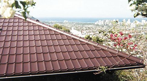

    Here's one you might like. No idea of costs.

    Great advice as usual guys. I LIKE that roof BTW.

    Hey, Jim, got any idea of the manufacturer of that roof? I like it!

    http://www.metalroofing.com/v2/content/manufacturer/ Don't remember, but it was from one of these.
    Flat metal roofs may not be that wind resistant, but many of the 'shaped' ones are guaranteed to 130mph and are used a lot in hurricane areas. As with anything, if it isn't installed properly, you'll have problems. The model for that one in the picture is Verona Peak (you can see that if you move your cursor over it and try to save it).

    Found it (Accel); thanks.
