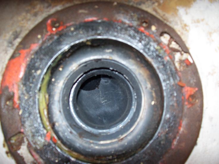

    I pulled a toilet to install a new tile floor and the flange is sort of borderline. It has one of those red outer rings that apparently was never anchored into the cement floor, since it still spins freely. The inside part of the flange is fine, but this red ring is very corroded and the bolts will probably pull out eventually (if not this time).
    Is the best way to repair this to cut out this outer ring and replace it with the same? If I do that, I'll have to cut the new ring in half to get it to fit under the lip of the inner part of the flange. Or should I leave it alone and try using a couple of those "spanner flange" repair kits?

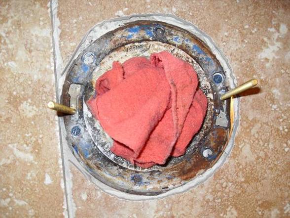

    I ended up using that. I pryed up the old one a bit and slid the new stainless ring underneath. Pryed both up a bit to give my self some wiggle room and dropped the bolts through the new stainless one. Drilled out the old anchor bolt holes large enough to drop a couple of Tapcons through and secured it to the floor. Worked real good. Thanks for the help!
    Oops, here's a picture.

    That doesn't look like nice new stainless...
    23,534
    Default ?
    Where is the stainless. That just looks like new bolts in the old flange. And from the looks of the tile line, they don't even appear to be in line with each other and parallel to the wall.
    I'm guessing the stainless is there, but it is completely hidden by the old flange. Is that right?
