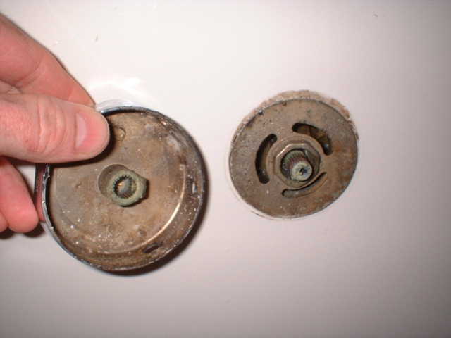

    Hello,
    I would like to replace my existing bathtub drain stopper with a new one because it is difficult to rotate the knob which raises and lowers the stopper (impossible if your hand are wet). Have taken it apart in the past and lubed it up, but the problem returns after a few months. Photos of existing setup are attached below. I think it is a poor design. It was installed in 1987 when the house was new.
    A few questions:
    1) I do not have access from the floor below due to a finished ceiling - but I do have an access from the wall at the facet end (interior wall). Based on the photos, is this an easy job or a difficult job? Any tricks or tips that you care to share?
    2) Is there a manufacturer or namebrand that I should ask for - ie. one that is reliable and will not get stiff over time like this one did? Local plumbing store recommends Gerberit (spelling?).
    3) Is there a special tool which makes the the drain piece in the bottom of the tub easier to unscrew - see photo attached.
    Thanks in advance for your advice/recommendations?

    With that tub you can use a Geberit cable operated one which is similar to what you have but is plastic. You could use a standard lever operated drain. Or you can install a push/pull drain which does not have any mechanical mechanism to corrode or seize up. There is a tool, called a "smart dumbbell" which may remove the bottom drain fitting, but since both pieces of the drain are brass it may be corroded to the point where it will require that it be "cut out".

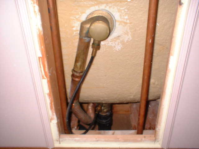

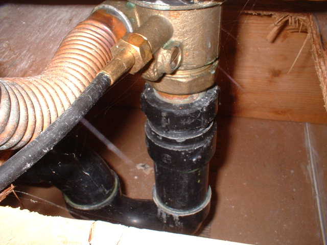

    Bought a "dumbell" and was able to turn out the threaded drain piece - no problem. Also bought an OS&B (Model 314Q-CP) bath Waste and Overflow with a chrome "clicker". Opened the box at home, looked at my plumbing and figured out pretty quickly that it won't fit in my situation.
    Please take a look at the first two photos that I posted above. Anyone know what Manufacturer this might be based on these photos?
    To make the replacement easy, I need a bath Waste and Overflow which has a large brass "T" connected directly below the tub drain. The waste water flows vertically straight through the "T" and into the trap below imediately below. The horizontal leg of the "T" is connected by a flex to the overflow.
    My problem is that there is 2x4 framing at the front of the tub at floor level - no room to connect the drain there - which seems to be the standard configuration.
    Took a look at the Geberit bath waste and overflow and it won't fit either.
    Words of wisdom from the more experienced?

    Oh, by the way - on the second photo, the drain for the tub is immediately above the large brass "T". The threaded piece inside of the tub screws directly into this brass "T" from above.

    Don,
    What you are asking for is called a "Direct Drain" bath waste & overflow assembly. I noticed you bought the clicker / toe touch for a replacement, which happens to be about the only kind of direct drain waste assemblies I normally see in the supply houses besides the lift and turn stile.
    I believe your current waste & overflow is also OS&B as they are the only brand I've ever seen manufacturing a cable operated direct drain waste although I've personally never seen thier model in brass, only plastic.
    OS&B makes the direct drain waste & overflow assembly in almost every style available, but I can imagine most would be special order.
    good luck.

    Hi Clayton -- Turns out there is a floor joist right where the drain would need to go on the Geberit tub waste overflow - probably why a direct drive waste was used when the house was built.
    So I ended up installing an OS&B 314DC-20BCP brass cable driven direct drive unit. To install the new strainer, however, I didn't need the dumbell wrench - instead OS&B uses a small 1/2" waste bolt to screw the strainer down to the waste elbow. The waste bolt is slotted. My largest slot screwdriver did not have a tip that was wide enough to catch on both sides of the slot in the waste bolt, so I ground a rigid scraper on both sides to essentially make a wide slot screwdriver about 3/4" wide. It worked OK, but now I am curious - do you plumbers have a special tool for this? If so, what do you call it? Might be a good excuse to go out and buy another tool!
