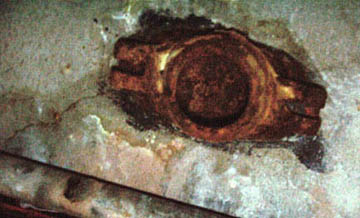

    I removed the trap from my laundry tub drain because it was starting to buckle and leak - and in the process the cast iron ring around the top of the drain cracked in half, together with a lot of corroded and/or rusted additional junk. The tub is old - from a 1910 house, and probably original - with 2 drains that sloped down underneath into an oblong "cup" directly against the underside of the tub (see photo) that emptied into one drain. The ring that cracked was around the oblong cup. The sloping parts seem to be part of the "cup" (I took the screws out, which were badly rusted, but can't get the rest to budge...it seems to be rusted on). The sink might be cast iron or concrete...about 1 1/8" thick. The colors are a little off - it's grey. The drain was 1 1/2", the holes about 1 1/2", edge is about 1/2"-5/8" from tub divider, which is about 1 1/8" wide - so about 5" total, edge to edge, or about 3 5/8" center to center. Is there anything I can do to get a working drain again? The washer empties into this! (I'm a sometimes handy homeowner). Name:  underneath_sink_03_.jpg

    Looks like it's time for a new fiberglass/ plastic laundry tub. It is most likely concrete. A sledge hammer will make short work of it and it can be carried out in pieces and in a 5 gallon bucket.
    It's a putty cup connection. See if you can find a new putty cup tail piece and a putty cup washer and bolt it back on the drain connection and hook it back up to the trap.
    Or replace the damn tub. Four pound short handled sledge will do the trick.

    You would have to find a funnel taipiece and bracket, neither of which I have seen in the past 30 years, although if they are still common in your area a good hardware store may have them. Offhand, I would say that your best, and maybe only, option is to replace it. But if its only function is for the washer drain, you may be able to install a trap and standpipe for the washer.

    Search for {"funnel tailpiece" FG0025}. I'd post the result, but it's one of the forbidden URLs on this forum. I'm pretty sure it is what you're looking for; about $20. Thanks to HJ for coming up with the name of the thing.

    It used to be called "putty cup". and you would order it with a putty cup washer. Just a beveled rubber washer.

    You don't "get the rusted one out" from what I see in your picture. That piece is part of the sink. Two bolt heads slide into those slots, then the funnel tailpiece is placed against that tapered portion, with putty in it, and a cast iron retainer, either a new one or the one from your old tailpiece slides up against it, and two nuts and washers are threaded onto the exposed bolts to keep everything together.

    Talking luck is with you--maybe
    you might have goten lucky and got that
    putty cup to come out , but I have never
    touched one that did not leak or seep out
    through the concrete edjees of it......
    if it all goes together and everything looks good
    well you got lucky
    if it leaks a slight bit, I have bought a full tube
    of clear silicone ...and after totally drying
    the whole area .... smeared the whole tube
    up there and made a very thick "half assed" seal
    moulding it with my hand around that putty cup
    that has got me out of lots of troubles over the years...
