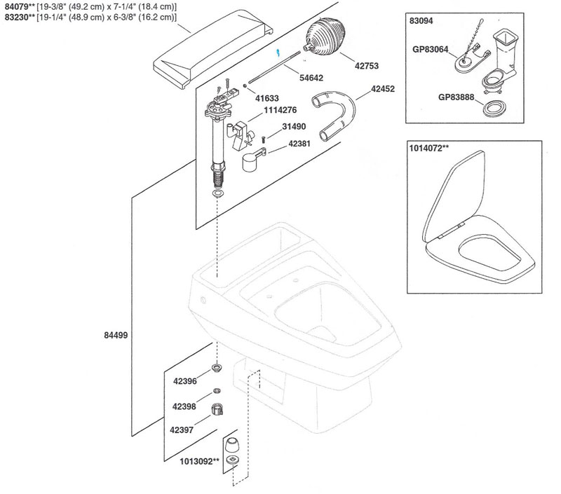

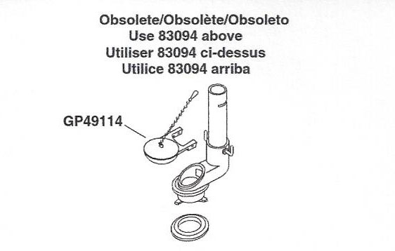

  14. #29
    14,202
    Two more pictures
