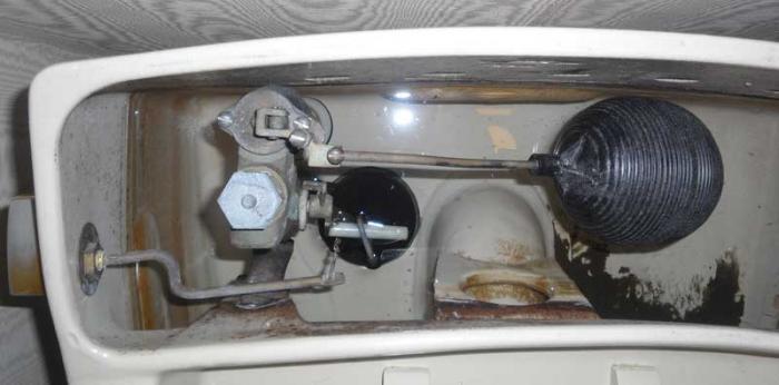

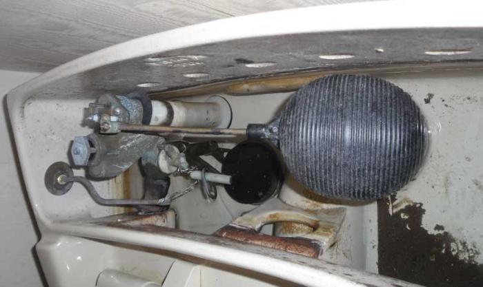

    I have (6) Kohler Rochelle toilets in my house... and I'm wondering if they might be the source of the groaning, moaning, vibrating noise that occasionally occurs at random times.
    I'm curious to know if there are any "NEW TECHNOLOGY OEM REPLACEMENTS" for the Ballcock assembly that is inside the tank. This one currently uses the float ball on a long rod / arm.
    I've attached a picture of the current assembly. I'm wondering where I might find either an OEM Replacement, or a newer style that might be more reliable??
    Thanks in advance,

    Default Or... would you suggest a REBUILD KIT??
    If such a thing exists... would it be more prudent to just rebuilt the existing unit with new gaskets, washers, seals and valves?
    Is there a KIT available?
    Thanks again.
    Default rebuild kit exists
    You can get it from a plumber or Kohler, it is part 30668. Don't throw away the old parts - they are actually worth something. I for one am willing to pay for the lift wire, my sister threw away the old one and the new one has too light of a gauge. Ack!

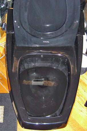

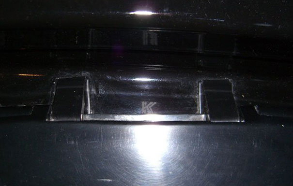

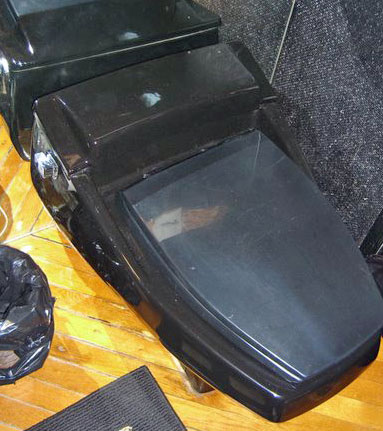

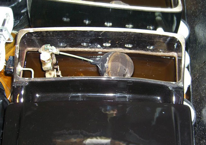

    Default Kohler Toilet, K-3385EB Rochelle one-piece needs parts
    My mother has a Kohler toilet which I am looking for replacment parts for. My problem is I cannot locate this model online, and have no clue what the model number is. I have attached several pictures to help identify this model. Anyone's assistance is appreciated.
    14,191
    http://www.terrylove.com/forums/showthread.php?t=895

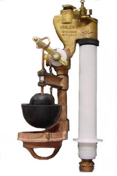

    It may be this part.
    You can get it from a plumber or Kohler, it is part K-30668.

    14,191
    Here are some more pictures of a Rochelle

    I have a Kohler "Old Style" Rochelle Model #K-3385-EB (30886) which is leaking down the back of the toilet indicating that the valve is not completely shutting off. I can hear a slight trickle of water even after the ballcock is in the closed position. When I pull up on the ball by hand the water shuts off, but it won't shut off due to a rising water level in the tank, even if I bend the rod down lower. I have replaced the following parts (51251, 51420, 51250, 51288, 20504, 51291, 51435, 51444, 51230, 53154, 50159, 51350). I have completely replaced the valve parts with no success; there is still a trickle I can't get rid of. I can't understand why the valve is not shutting off. Kohler has not been helpful on this point. To replace the entire unit would cost $350.00, probablly not a good investment for a 15 year old toilet. Should I buyt a new part 51428? Can you offer any suggestions for why there is still a leak and how to fix it other than replacing the entire fixture?
    21,376
    This is exactly the main reason people sometimes shy away from Kohler...they 'roll their own' and often use custom designs, then because the production is low, and they change it often, aftermarket usually doesn't make parts available, either. I do like the way much of their stuff looks, but it can be a bear to keep it working. No way would I spend $350 to replace that part...I'd much rather invest that money into a new toilet that probably would work better and save water and sewer costs with each flush AND I could get repair parts for cheaply and easily. The vast majority of toilets out there use a few common parts. Unless it is a weird designer color, maybe now is the time to look into something newer. All of the newe toilets are required to use 1.6g, and that may change to 1.28g. Many work quite well with that lower flush volume.
    If you are lucky, you may be able to fit a 'convential' fill valve into your toilet, but a plumber, familiar with that, would be needed to tell. If so, then, the entire mechanism could be replace for less than $15 off-the-shelf from nearly any plumbing or big box store.
