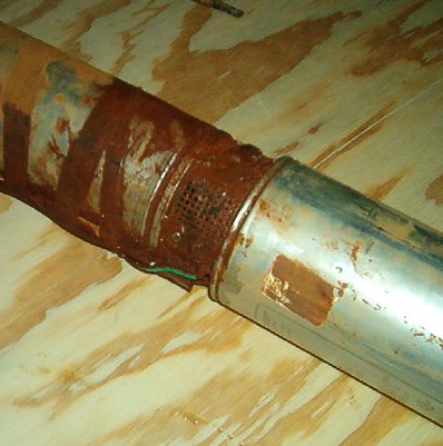

    Yes, I understand. The condition I am calling "sludge" is actually just a richly-red water with very small solids ... I have just tried to upload a picture of the screen on the old pump.

    The sludge is IRB (iron related bacteria). It forms the sludge and hard encrustations that will starve a pump for water. I've pulled pumps worse than yours and used a chisel on the screen. An iron test can not identify IRB.
    I suggest the air lift the driller suggested, and then shocking the well running highly chlorinated water through out the house to all fixtures after by-passing all water treatment equipment and then sanitizing any softener and/or backwashed or regenerated filter.
    Shocking the well will kill the bacteria but it is a temporary 'fix' and repeated shocking can cause more encrustation; especially on the well screen which reduces the production of the well.
    Then you do well cleaning/rehabilitation or drill a new well. In this case you could also use a pellet dropper on the well to constantly dose chlorine to prevent the bacteria from recolonizing the well and causing more problems later.
    After cleaning the bottom of the well of sediment, air lift purging will clean the screen if they use acid and control the pH to 2 for a few hours and then take the pH to 12 for a few hours and then adjust the pH to 7 and then shock the well. The process will clean the screen and (any) gravel pack and get back into the aquifer some. There are chemicals to do this with an the driller if knowledgeable of rehabing wells, may have his way of doing it without controlling the pH; which IMO is not as good as controlling the pH. No bacteria can survive the radical swing in pH in such a short time frame. If 180* water were used, it's even better. Also, the use of a brush for your size casing is a good idea and usually necessary. Otherwise you don't get all the encrustations and bacteria under them.
    IMO your pump should be set just above the screen or more correctly, 10-15' below the pumping level of the well; wherever that is in the well. Your present pump is more than adequate for that. It is a Gould's 5 gpm 1/2 hp pump, although I wouldn't have used it. I would have suggested a 1/2 hp 10 gpm.

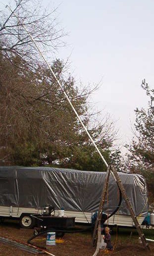

    Well, you were correct, Bob! I rented a gas-powered 2" trash pump, removed the foot valve from the end of the suction hose and added 35' of 2" pipe to get to the bottom of the well ... and after I finally got the pump primed, I only got red-tinted water for the first couple of minutes before the discharge appeared completely clear. But, the bigger pump at least pulled that "red" out of there all at once rather than my new pump delivering it to my filters a pinch at a time, eh?!

    Please pardon the length of this post, but I also thought you guys might enjoy a look at my "rig". The ladder and a rope let me lower the suction hose while adding pipe on the way down, and the tree is presently holding all of that for me until morning ...

    Nothing wrong with that rig. It works, that's all that counts.

    Well, my question at the moment is whether the hypochlorination treatment might address the matter of removing buildup on the new pump, but in a few minutes I will nevertheless be heading off to get some chlorine!
    Here is the latest:
    Within the past hour, I used two cold-water spigots as throttles -- one was an open tub faucet and the other was a service spigot with a hose going into my sump so I could watch for bubbles -- inside the house to relieve enough pressure so the pump would run at a constant 40 psi while I *also* had a garden hose running wide open in the back yard. My net pressure at the last guage ahead of the garden hose was 30 psi, and I got about 10 gpm at the end of that hose with the other spigots still open and the pump running as just stated. So, and overall, I am sure I am getting at least 12 gpm, and that is with the pump maintaining 40 psi at my first guage.
    However, and here is the most-recent troubling discovery: The breaker for the pump circuit was already tripped when I first arrived in the basement to run the above flow test. My previous pump had also begun tripping the breaker just before I installed the new pump -- the old pump would start and run after I had flipped the breaker on-off-on a few times to get it going, but it would not start as it should after a following period of rest.
    Maybe a chlorine treatment will loosen the gunk and clear this newer pump before that same fate becomes it own ...
