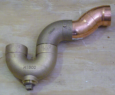

    Is this arrangement code compliant? I think it will get me where I want to go. It is a copper p-trap and two street 45s. The tub tailpiece feeds into the p-trap, then the last 45 is connected to a short nipple, then enters the existing DWV wye, where the vent stack joins the drain. This is all 1 1/2" piping. Thanks.

    If you can shorten the piece coming down from the tub, raise up the trap, and eliminate the 45s then it will work. Do you have a vent there somewhere?
    You don't want to install it the way you are showing it.
    Why arent you using a banded coupling from copper to PVC pipe to PVC trap and up to the waste and overflow with a desanco / trap adaptor?

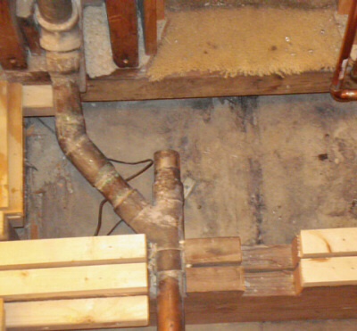

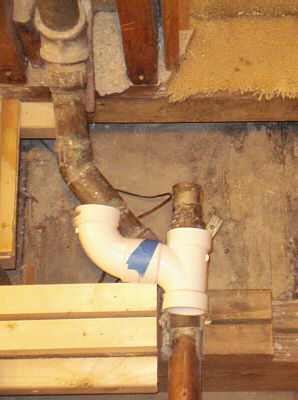

    Here are some more pics. The first pic shows the copper wye and vent pipe. The tub trap (not shown) goes in the notch in the joist. The wye, as you can see, is just below the top of the joist.
    Second pic shows what I think will work. From the vent line, use a banded coupling to connect the PVC 90 deg. elbow. Then a short length of PVC into the sanitary tee. Upstream of the sanitary tee would be PVC, eventually reaching the tub tailpiece. Downstream of the sanitary tee would be another banded coupling, which connects into the existing copper drain line.
    The two basic questions here are 1. Is this code?, and 2. Will this work? Thanks again for all the assistance.

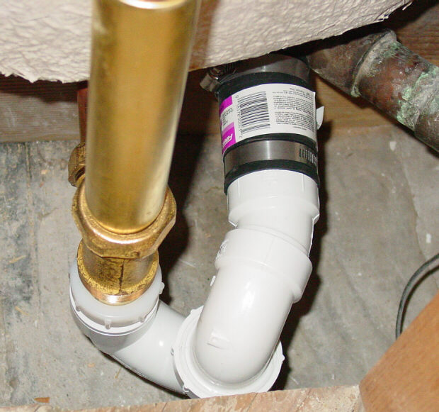

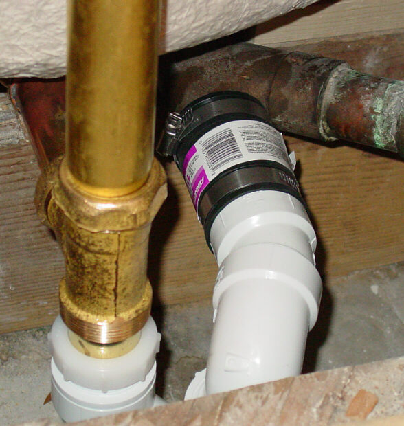

    Is this kosher? Here is the setup:
    1. Kohler pop up drain assembly tailpiece
    2. 1 1/2" PVC p-trap
    3. 22.5 degree 1/16 street bend
    4. short 1 1/2" nipple (not visible) on hub end of 1/16 bend, inside of Fernco
    5. 1 1/2" Fernco coupling
    6. cast copper wye (existing)
    The trap arm and existing drain line are about 4 1/4" offset, which is why I needed the 1/16 bend.
    You can see the vent line coming in from the right.
    p.s. I still can't see these photos in the thread, they are shown as links which are only viewable when you click on them. Is there a solution to this?
    23,523
    Default drain
    1. That Fernco is not approved for that location.
    2. You need a proper "transition" coupling with one side sized for PVC and the other for copper.
    3. I would not use a "union joint" trap in a location like that. The nut joining the two parts can crack and cause a leak.
    4. That short radius trap will cause problems if the drain becomes obstructed and has to be snaked some day.
    Engineer chassis's Avatar
    Sep 2005
    SE Pennsylvania
    339
    hj,

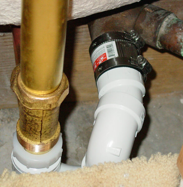

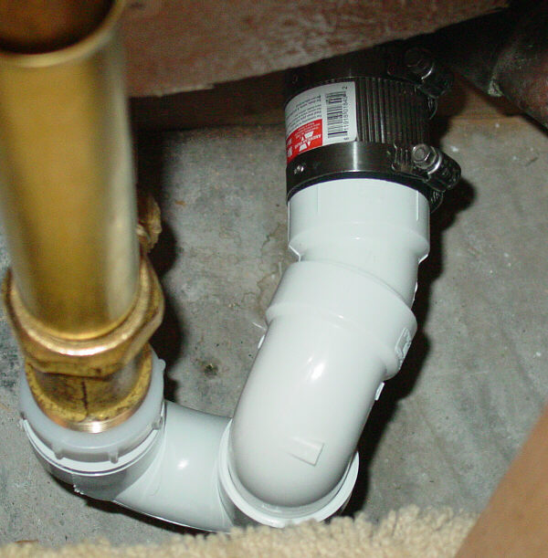

    Thanks for the feedback. How does this look? Here is the setup with some changes:
    - Coupling is now American Valve No Hub Coupling 1 1/2", part no. RNH40. I took out the Fernco Plumb Quick P1056-150. The Fernco label indicates it is for use with copper, steel, lead and plastic.
    - Trap is now a solvent weld; no union nut, except at the tailpiece.
    - Still have the 1/16th street bend and short nipple into the No Hub.
    I don't understand the point about a "short radius trap". All the PVC 1 1/2" traps I looked at at HD and Lowe's had the same radius on both the bottom u-turn and the outlet ell.
    Thanks.

    23,523
    Default drain
    The problem with the Fernco was not the size, it was its material and design. If it were being used outdoors AND underground it would have been okay. Indoors, whether above ground or below, it cannot be used. If that is truly a "NoHub" coupling then it is also improper because it is made for cast iron on both sides. You need a transition sized for PVC on one side and copper on the other. That is a short radius trap because it has the union joint and is intended for use under a kitchen sink, not under a tub. You should be using the one with a glued joint between the two pieces.
    Sep 2005
    SE Pennsylvania
    339
    Thanks for the feedback guys. hj, do you have a recommended manufacturer for a transition coupling? HD and Lowe's don't carry anything besides the improper Fernco in the earlier picture. I have a couple good plumbing supply houses nearby, but want to know what I am asking for.
    The flexible coupling I used is American Valve RNH-40. It's made from neoprene if that matters.
