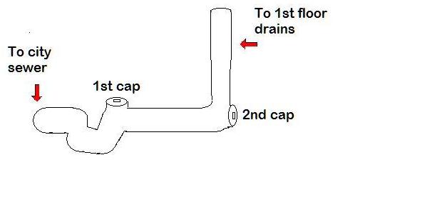

    I need to install a drain for my washine machine in the basement. Problem is the old cast iron only has two cleanout caps (one vertical and one horizontal) and clearly was never meant for adding anything. I have already removed the 1st cleanout cap above the main house trap (there was water in the bend so I assume it is the main trap) and I was planning on adding a Cast-Iron/PVC adapter using Oakum and plastic lead. I would then bring a PVC 1 1/2" pipe over about 2-3 feet and into a trap with would then lead up above the height of the Washing machine.
    Is this a bad idea to add a drain into this trap? I dont have many choices since the old washer drained directly into the bathtub and has rotted out part of the bathroom floor (which is a whole other project for me).
    Any suggestions or comments? Thanks!

    Sounds like it should work for you. I'm assuming this is temporary. You're probably required to have a vent, but it may work without it. I've got a similiar situation now. Moved the cleanout (used a saddle tee) up stream and then tapped into the cleanout w/ an adapter to 1.5" for a sink and washer. Works fine. If you do need a vent, an air admitance valve might work for you.

    It will be only be temporary until I can figure out how to make it permanent. Ive heard about air admittance valves but am not sure how they work. Where would it be installed in relation to the trap? Ive only had to replace/repair plumbing in the past so I am not familiar with adding a new line.
    Does it matter how far away I bring the pipe to the trap and washing machine? I was planning on placing the machine about a foot to the right of the 2nd cap which would make it roughly 3 feet across.

    Most newer washing machines require a 2" drain line. An aav basically has a rubber diaphram (it should be normally closed) that when a suction is generated by the water flowing, allows air into the system so the trap is not suctioned dry. if there is a backup in the drain, it will come out your drain.
    I just finished doing pretty much what you want to do. I'll try to get a picture up. Use 2" pipe instead of 1.5" and also, my washer stated to use a standpipe (the upright pipe the washer drains into) of at least 30" high.

    So the aav should be somewhere between the trap and the main drain?? Is there any chance of this setup interfering with the main trap for the house??
    I also want to bring a hose from my de-humidifier into the same pipe as the washer drain so I can stop emptying the bin. I figure since a washer hose is typically loose inside the standpipe it wont hurt to have something else trickle beside it. Is this true?

    But the washer pumps out the water. I doubt the dehumidifier does the same. Unless you have the dehumidifier higher than the drain. I say this after I have poured out the second 5 gallon bucket of water from my own today.

    I actually do have the dehumidifier up high so it can drain properly. Really just a trickle comes out of it though.
    I had already used 1.5" pipe on the drain for the washer, otherwise I would have used 2". The washer seems to drain fine anyway. I may redo the whole thing with 2" when I add an AAV, but I havent decided.
