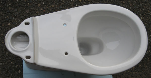

    I got a new Caroma 305 with dual flush from the water company here in San Antonio,Tx. I was wondering if there was any way to increase the water level in the bowl. I am disappointed in the #2 flush and have to use my toilet brush quite often.
    Thanks,
    Patty
  7. #22
    19,204
    Buy a different toilet! No, unless the thing is not working right, the bowl is overfilled....it has an opening behind you can't see that drains any water above the maximum down the drain. If you pour a bucket of water in the bowl (pour it too fast and it will flush), then let it sit, that's the maximum level it can get.
    Many dual flush bowls, like the Caroma, Kohler Persuade, and the Toto Aquia have little water in the bowl. That's the nature of them. The Caroma glaze seems a bit rough though, Terry

    We recently bought the Caroma Sydney 2 pcs. (Tank 622322W, Bowl 609159W). After we installed the toilet, we encountered problems with the flush. As you can see in my video http://video.google.ca/videoplay?docid=-1855798188535347905 from the internet, with every flush the water will splash up everywhere on the seat and cover. When there is a number 2, there are shit droplets on the seat, very disgusting.
    We contacted the company with no response. Could you tell me how to fix my problem?
    cslee
  15. #30
    DIY Senior Member Probedude's Avatar
    Nov 2008
    CA
    137
    Quote Originally Posted by Reader Review View Post
    cslee
    I've looked at a few Caroma videos on YouTube and they all look like they do the same. All the water dumps from the rim, none of it below the water surface.
