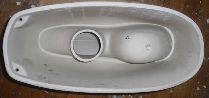

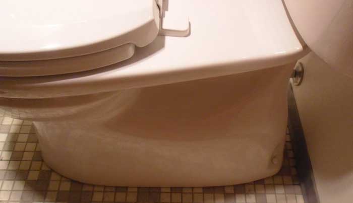

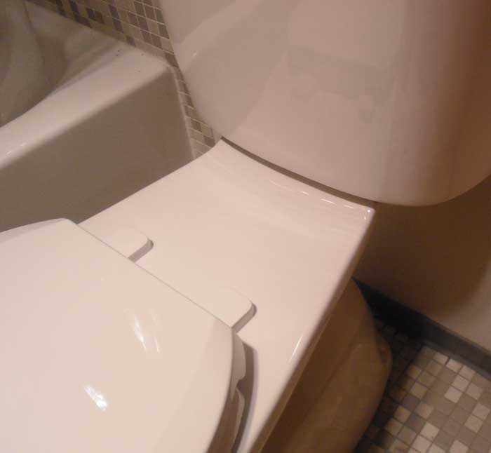

    The Caroma Sydney comfort height round 270 bowl
    The side of the 270 bowl
    Where the seat attaches
    Like many dual flush toilets, there isn't much water in the bowl.

    The 270 bowl uses an offset adapter so you can adjust the rough-in from 12" to 10"
    Underneath the Caroma 270 bowl.

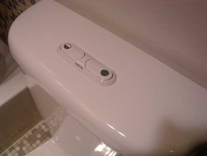

    Inside the Caroma Sydney tank
    Dual Flush buttons
