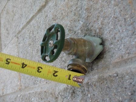

Attached is the best pic i took, most are badly blurred due to the close range and my hands moving the camera. The vacume breaker is off andin the wife's car. She is not here, but it looks exactly like the drawing above and is silver or nickle in color. The threads in the picture near the tape are fine machine threads, not the standard pipe thread that is on the hose end. :(

You didn't take the whole breaker off from the hose thread.......

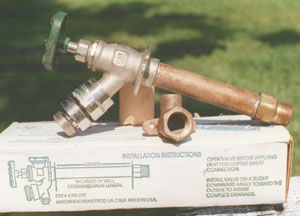

I found this photo on a code violation page which just showed this as an example of an approved faucet, but doesn't list a name or anything like that... was just a kind of home inspection example page. Can anyone identify the make on this, from what can see, this looks exactly like the one I have. I can not see the other end of the pipe though because it goes in to a finished basement and is behind drywall. Below is the text from that page.
The plumber has not installed an outside faucet (hose bibb) that meets the Minimum Standards of the Codes. Notice the armor-flex insulation. The hose bibb is only supported by the solder joint, a joint easily damaged from normal torque on the handle, and there is no protection from freezing. The Uniform Plumbing Code requires, "In climates where freezing temperatures occur, a listed self-draining frost proof hose bibb with an integral backflow preventer shall be used." No Exceptions! The IRC requires an accessible Stop and Waste Valve be installed inside the building - then makes an exception for Self Draining Frost Proof Fasucets. So, they are still required, but with an option to control draining from inside the heated building, which is much more expensive. Seen Here, this faucet is a simple inexpensive ($3.00) hose bibb used for washing machine hose connections. It is not frost proof, and contains no backflow prevention device. A key word in the Code requirement, is integral; meaning a part thereof. Installing screw-on vacuum breakers ex post facto, does not meet the Listing’s intent of a non-removable vacuum breaker, and provides no frost protection. The faucet must be replaced with the approved (Listed) self-draining frost proof type with an integral Vacuum Breaker for back-flow protection. Below, we see an approved (Listed) Faucet only costing $17. 00. Self-Draining frost proof faucets are equipped with an integral Vacuum Breaker which only allows water to flow in one direction. This prevents a back siphonage from a hose operated device, such as but not limited to, a lawn insecticide sprayer that could contaminate your drinking water. The vacuum breaker can be removed for cleaning or replacement; however, the vacuum breaker has a finer thread at the end connected to the faucet, thus prevents a hose from accidental connection while the vacuum breaker is removed. IRC P2903.10 Frost protection is achieved from the valve's "Stop" location at the brass seat ( far right of the faucet) where it will be embedded in the warmer stud wall behind the brick. The water will actually be cut off deep inside the structural wall framing, and drain out of the faucet. The faucet must be installed with slight fall for gravity drainage. Seen here, is the 6" copper tube model for installation in 2x4 stud wall thickness with brick veneering.
Some of those have one-way threads (not sure how they do it), so that it locks. Maybe a spring loaded coller that closes over the lip once you get it screwed on? Some have a locking screw, which should be easier to take off. Worse comes to worse, a big pipe wrench or a hack saw should get what's left of the vacuum breaker off. Slice it on opposite sides, and it should fall off, or be coerced off.
The faucet shown has two components...it is a frostproof valve with an add-on vacuum breaker. If you don't need the frostproof valve, take the vacuum breaker (or what's left of it) off and replace it with a new one. Or, take out the whole thing and replace it. If the valve works, replace the vacuum breaker.

It doesn't come off, the part you see there above the tape appears to be sodered on (or some type of really hard glue). You can see a very thin bead of it going all around the edge when you look down on it from above. That piece in the photo that the tape is on does not screw off. Looks like it should but does not. :(
The faucet works fine, and it is the vacuum breaker replacement I am looking for, but haven't been able to find it anywhere. I have found vacuum breakers at the local plumbing supply but they are all pipe threads on both ends. This seems to have some mutant 1 inch (+) machine thread on the faucet end. I'd even be willing to buy the whole thing again for the $17 it said it cost in the home inspection thing and just take the vacume breaker off the new one and attach it to the one I have currently if I could just find a place to purchase the silly thing. :)

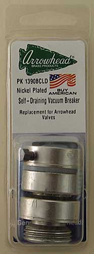

I couldn't read all the responses on this thread but I'm pretty sure that faucet is a Arrow Head Brass faucet.

Thanks, I'll start looking locally to see if there are any Arrowhead at the plumbing shops here. I hope those are the ones, I really hate not being able to use the garden hose. :)
georgegraz
12
Do a google search on:
The first hit has a picture I think your looking for,
George
