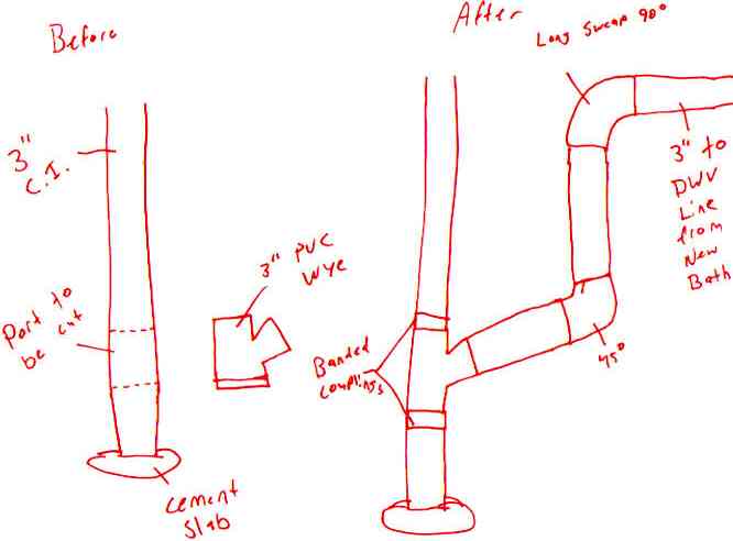

    Other than properly supporting pipes that are above, any tips for cutting C.I. vertical waste stack with snap cutters? I have already built a soffit around the pipe and will use steel riser clamps above and below the cut.
    Any tips for measuring or cutting if I'm going to use a 3 x 3 x 3" PVC wye and two banded couplings?
    Here's a quick sketch of my plan. Sorry if the drawing is messy. I'm a terrible sketch artist. The pipe is going 45 degrees for a bit to clear our laundry chute. Once clear, it'll turn up 45 degrees and then take a long sweep 90 degree turn or a turn with two 45's and a straight pipe to a horizontal waste pipe sloped at 1/4" per foot. Then it's heading up the wall to the attic.
    Thanks.
    I included a second sketch with a Wye fitting and a cleanout. It's a good spot for one.

    its better to cut out far more than you really
    need to ..... give yourself PLENTY of room to navigate
    youir fittings into place or you will live to regret it......
    an extra 18 inches of PVC pipe in that stack is not going to matter
    but trying to cut another 3 inches off after you have
    already tied into it can be a fun time......

    Cut more than you need and you can install the fitting with no-hub bans and pvc to no-hub adapt.
    Default tips for snap cutters
    Yo Coach! Ditto on the 3"pvc wye,give your self some flex w/the pvc pipe,your going to run 3"pvc up to the attic any-way.

    I may run the supplies up to the attic and then wait. But is it okay to tap the stack, make my horizontal run and the run it up a floor and cap it in preparation for when the upstairs is ready to rough in? I figure I can just cap it off and no sewer gasses would get in. Then again, the pipe would be in my daughter's room, who is just about two years old.
    Is capping the line okay or should I just wait until I can send the pipe through the roof? If I can tie into the stack and run the pipe up to the second floor, then I can begin building some soffits and feel like I'll have a good chunk of work done before I head back to my day job and have limited time and energy for plumbing.
    Any opinions? Is capping it safe or do you not feel safe until it's through the roof?
    Yes,capping or plugging the drain until your ready to move on with your project is adequate.
