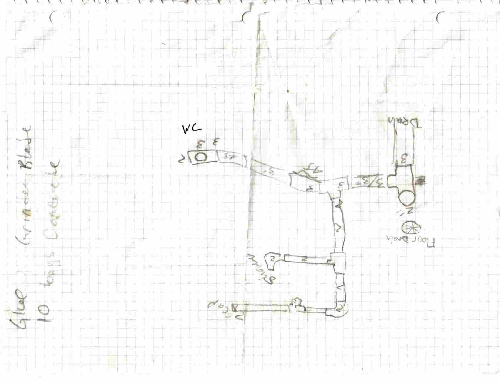

    Closer inspection suggests that there is no trap under the shower. It's hard to believe that someone who could build the entire bathroom group under the slab didn't put a p trap in. But honestly, I can't see any water in it at all. It just looks like an elbow.
    Here's the guy's drawing. Looks like I need to beat the shower stall out with a sledgehammer and see if I can install a trap. I think the slop drain in the laundry room also has no trap.
    I mean, is it possible that there is a trap farther down the line or something? I only had sewer gas that was noticeable that one time with the heavy rain.
    I'm thinking no. But it's hard to believe no trap is there. Check out the drawing. Guy didn't even use wyes for drainage.

    B4 I finished reading your post I was going to ask how you knew there was a trap under the shower .
    You said "It's hard to believe that someone who could build the entire bathroom group under the slab didn't put a p trap in." I see it all the time.
    The tip off was when you said "The guy who put this bath in was not a plumber."
    There should not be a shower trap anywhere else but at the shower drain, running traps are not allowed.
    Adding a trap to the utility sink should be easy. As far as the shower goes if the shower is used only once and a while you could use a drain plug when it's not being used unless you get sewer gas when taking a shower.
    Because someone can glue pipe together doesn't mean they know how to plumb correctly. Hire a plumber and get an inspection to be sure all is done right the next time. Tearing up the concrete is the only way to add a trap to the shower drain. His drawing does not show any traps. It looks like you may need to add vents also, if you tear up the concrete. It shows him using Ts where there should be Ys being used which may cause problems down the road with clogging. If you ever have to snake it you may not make the turns and if you do it may be going in the wrong direction. This looks like a handy man mess to me. How long have you been using it this way?

    If he did not know enough to put a trap under the shower, could mean that he also didn't know he should not use a running trap, but the odds are that if you can't see water in the drain there is no trap. Have someone flush a toilet while you listen at the shower drain. If there is no trap you will hear the flush.

    There's no trap. I mean, it's not pictured in his drawing and I shoved a snake in there and it went three feet before hitting anything at all. I can hear the toilet flush with my ear three feet from the drain.
    I'm going to try to make some time to redo the shower pan. I was thinking that I could beat the shower pan out with a sledgehammer, break up the cement around the pipe and put in a p-trap. Then I'd build a custom shower pan and tile the walls instead of using a shower surround. I'll have to research building the pan (I've looked at it before) but I'm hoping I won't have to break up too much of the cement he set the pre fab pan on. I'll just make the new pan slightly higher than the old when I scrim the cement.
    I'm also thinking that I'll open the wall behind the lav where he has that capped pipe and put in an AAV. I know it's not code, but I figured I'd see if it worked okay for now. Next summer maybe I'll have time to run that to a vent going thru the roof.
    What do you think of my plan? I will never hire a non-licensed plumber again. If I have any money after our current attic remodel, I'll hire a pro to do it up right down there and relieve me of my worries.
