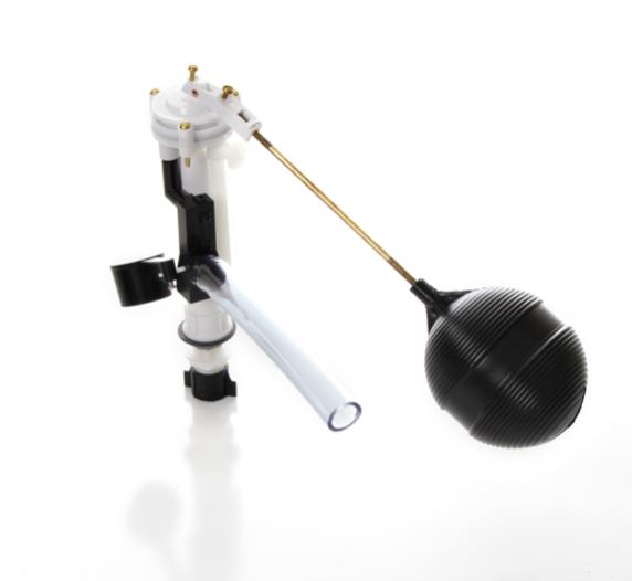

Yes it really does. Fluidmaster 400A works perfectly in my 1989 Kohler Rialto K-3402. Took out the old, installed the new by lowering it and dialing in the float so water level hits the fill line marked on the flush valve, rotating the existing rim tube, inserting the black bowl fill tube in the rim tube.
