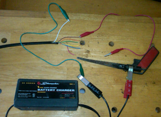

I have a Rainbird ESP-6TM controller which actuates the valves with 24VAC. Here's how I found my valves.
1. I shut off the main valve to the sprinkler system. If you don't know where the main valve is, you may turn off the valve at your water meter.
2. I disconnected the white wire (common) and the colored wire that controls the valve I was looking for, from the controller.
3. See photo below. I connected the black clamp from a 12V car battery charger to the white wire (green jumper in photo). I connected the red clamp to a saw blade. I connected another jumper to the colored wire (red jumper in photo).
4. Then I had someone run the unconnected end of the red jumper back and forth along the saw teeth while I walked around the yard listening for a clicking noise from the valve.
I was able to locate all six valves quickly in this way.
