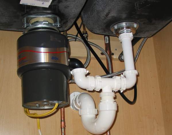

    I'm almost ready for my final kitchen ispection and had a couple of questions that I'm hoping you can help me with.
    1. Under my sink I have 2" pipe coming into the cabinet with a 2" trap. After the trap, the pipe is reduced to 1 1/2" where it goes into a "T" and then onto the garbage disposal on one side and the other sink bowl on the other. Does this set-up sound like I'm on the right track?
    2. Should the refrigerator be connected to the water outlet or will the inspector just want to see the water outlet?
    Thanks for the help.
    Gary

    You should see what I found under my sink. I'm curious what the pros will say about your setup as it is much simpler and easy to maneuver around than mine. I'm just wondering if that "T" can somehow disrupt flow from the disposal, but it doesn't seem likely.

    Sorry to chime in here; sure a pro will have the proper opinion, but that tee looks like a vent tee. Looks like there's a risk of either the sink or disposal backing up into the other. I suspect you have to have the right sink drain going straight down to the trap. The disposal might have to merge w/ that drain on the vertical portion via a wye or a sanitary tee.
    The 1.5" going to 2", though, is not an issue in my town. Round here, ok to go from smaller to larger in direc of drain.

    I prefer to have a "baffel" tee on the vertical and a pipe straight out of the disposer.
    Most plumbers would throw away the 90 bend that comes with the disposer.
