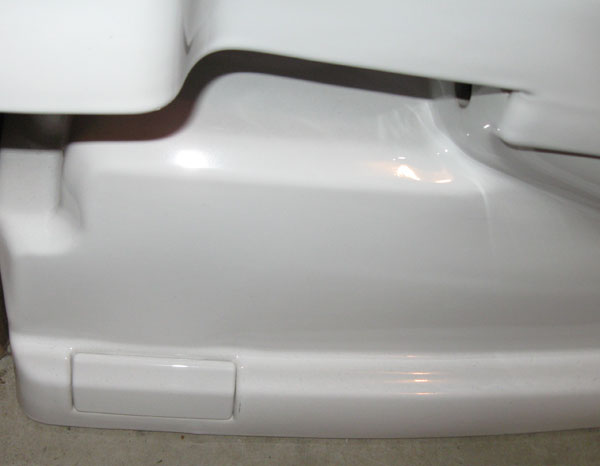

The best features are the comfort height bowl, the bowl is 16-1/8" before you add for the nice slow closing seat.
The skirted base, which makes for easier cleaning.
When replacing bowls, this is nice, it will cover almost any footprint that has been left on the floor.

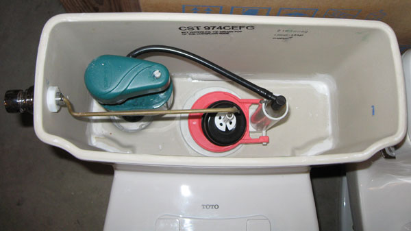

Toto Guinevere toilet and supply location
I want to replace a 1920's toilet with a Toto Guinevere. Toto recommends a supply 8" left of center and 4 1/2" from the floor, but my supply is 6" left of center and 12" from the floor. I would have to damage a nice subway tile wall to relocate it, so I'd rather not.
It looks like the supply might fit in below the tank -- the supply projects 5" -- but Toto's drawings don't give measurements in that area. Does anyone know if that supply location would work with the Guinevere?
Six inches from the left of center works with a 1/4 turn valve.
And 12" from the floor means you can have the valve 3" to the left of center even. There is plenty of room for the shutoff.
Installed and ready to be caulked at the floor.
