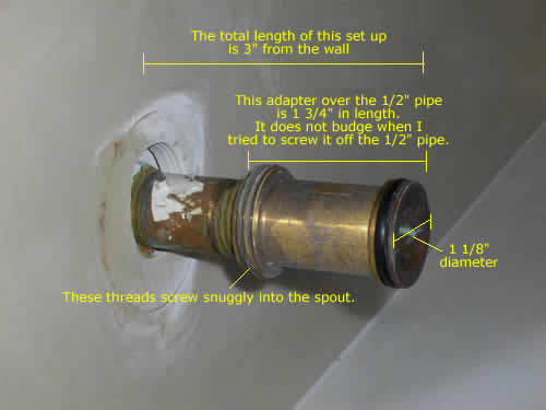

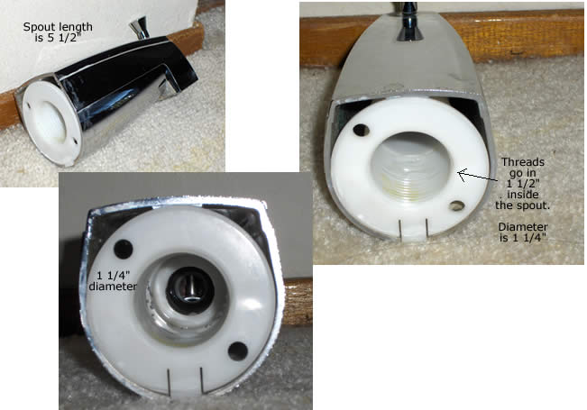

    My tub/shower diverter spout is leaking when the shower is on. I know that I need to replace it, but I'm having a difficult time finding a diverter similar to my old one that will fit over the copper pipe that sticks out from the wall. Diverter uses thread connection, lift-gate. The hole with the threads is 1-1/4" in diameter. The pipe from the wall is a standard 1/2" diameter copper pipe with some kind of adapter screwed onto it that threads into the 1-1/4" opening of the spout. The total length of the pipe plus the adapter is 3" from the wall. I tried to find a spout that has the 1-1/4" opening, but no luck. I even went to a local plumbing supply shop that's supposed to have "everything", but the guy said he'd never seen a spout with that type of fitting (he might be inexperienced, I don't know). I tried to unscrew the adapter from the 1/2" inch pipe, but it won't budge. I didn't want to force it out because I was afraid I might damage something, so I'd like to keep that in if possible. I've attached a couple of photos that might clarify my description.

    The solution from that thread seems to be to use heat to loosen the solder, if the adapter was soldered on. I don't know if my adapter is soldered on. I would like to keep the pipe the way it is if possible, because I don't want to do anything to damage the pipe and I'm only replacing the spout. So it seems my only alternative is to contact Delta to see if they still make a spout like this. I'm not too hopeful though -- I know this spout is at least 14 years old (that's when I moved into my house.) I'll contact Delta tomorrow.

    Looks like a standard Delta spout to me.You should be able to just take the adapter out of a new one and screw it on.Try a different supply house.

    It's Delta all right.
    The adapter is soldered on, and then the spout threads onto it.

    Well, Delta got back to me and said they don't carry a spout with the 1 1/4" diameter hole. But I don't think he understood that the adapter probably came with the spout! If it's a design that's probably discontinued, maybe I shouldn't spend so much time looking for a replacement and instead learn how to take that adapter off the 1/2" pipe. I really don't want to do that though, unless I have no other choice. What I thought would be a simple spout replacement is turning into a solder-removal-then-cut-pipe type of job.

    No,you're making a simple job way too difficult.Let me try restating what I said before.
    1) Go out and buy a Delta spout
    a) you can buy a rp5834 spout,it comes with a 1/2" FIP adaptor but that doesnt matter (why? see step 2) and it has the same pull-up diverter as your original spout:
    or
    b) you can buy a rp5836 spout,which comes with the slip on adapter,it has a "pull down" diverter but thats not a problem operationally.
    2) Now here is the key step.Take the new spout you bought,remove the adapter AND THROW IT IN THE BUSHES!!!
    3) You now have a spout which will screw directly on to the existing adapter.Celebrate with a cold adult beverage.
