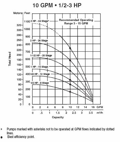

>>>True but not true. If your well can only pump 12gpm, then 12gpm is all you will ever get.
You need to look up some pump curve charts. Even a 10 gpm 1/2 hp sub will pump more than 12 gpm. I've provided one here below.
I've never seen a pump sized too small to provide the max gpm the building requires plus some reserve gpm. I've never installed one either. But the figures were yours; using 15 gpm and the 12 gpm was from the well.

(Gary said)As to well water systems... ALL submersible pumps can (must) deliver more water than the household actually uses OR the house would be out of water at high usage times.
>>>Not true at all. Regulations require pump to be sized strictly to well depth and recovery rate, and pressure tank and piping to be sized in accordance. No more and no less. And of corse the family will never use more water than they can get into the house. The family will either have to get use to not having 15gpm from a 12gpm well, or else do something diff.
"Not true at all"!! IS TOO!! lol There are codes as to the minimum psi a water system must provide. It doesn't matter how many fixtures are in the house/building, the system has to provide the minimum psi if one or all of them are turned on. In your statement, the pressure would not be but a few psi and well below the minimum.
A 12 gpm well means the recovery rate gpm of the well. It has next to nothing to do with the volume of water provided to the house/building or the total volume the pump and plumbing can deliver to the house/building. The total 'head' is based on the water level in the well though.
You can size a pump by the 'pumping level'. That is where the recovery rate equals the rate the water is being pumped out of the well AND where the water level in the well stabilizes, meaning the pump is removing as much water as is running into it (recovery rate) AND the pump has drawn down the well of all storage. A 6" well has 1.47 gal/foot of water. Usually you would set the pump 10-15' below that water level as measured from the surface. That is only one way of sizing a pump and I don't suggest it due to the possibility of dry periods causing the water table to fall from time to time, creating a dry well condition.
What "Regulations" are you talking about? I've never heard of any regulations on sizing a submersible pump anywhere in the US or Canada, and I pay close attention to these things. You can size a pump for the pumping level of the well as described above or 10-20' off the bottom of the well. That applies to rock bore wells, not cased and screened types which you would usually size the pump from the highest producing screened area.

All non-backwashed (upflow), automatically backwashed or regenerated filters and all softeners (both manual and automatic) have a SFR (service flow rating) gpm that is established by the mineral or resin manufacturers.
>>>Very true. What I was referring to concerns placing a 20gpm pump into a well that recovers at, lets say 15gpm. Im sure that you have witnessed some of the people out there who actually believe this will work, and it will...for a very short time
>>>You're right about the figures. I blew this one! Lol! There are several wells around here that are sized too small, but there is nothing that can be done. There are several even around 5gpm, and the owners dont want to mess with elaborate reservoirs and such, so they must live with it
