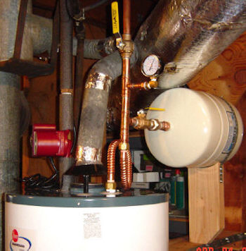

    If it helps, here is a picture of my installation of an expansion tank. It's right next to the water heater. Space constraints required that I install it horizontally so a proper support in a form of a 2x6 and a metal strap was added to this installation.

    Talking jk60 ---thats pretty!!
    I like the silver duct tape on the crooked chimmney....
    it gives it all a christmas kinda feeling.....
    but the expansion tank looks pretty solid....

    Quote Originally Posted by jk60
    That answers my question about distance from water heater. What size tank is that? My suggestion to the plumber was to come up on the cold water side with hard copper then a tee. Take the horizonal line back to towards the wall where the cold water supply comes through and put the tank on top. That way if it does leak it should run into the water heater pan although it may cause problems dripping on the heater but I'd rather have that than water running on the adjacent hardwood floors. The only expansion tanks available locally are for water pumps and they are rated for 125psi and don't mention temperature. Obviously when the pressure goes up hot water travels backwards a little ways in the cold water line so the two concerns I have left is the weight of the tank and if they are a specialty tank versus the standard water pump tank. Thanks for the pic.
