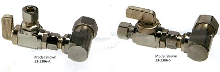

Dahl makes a shutoff that is tighter to the wall for this situation.

You may also be able to get by with the Dahl valve. It doesn't take up much space.
Or, you can move the bowl out 2" with the 10" Unift.

Terry, thanks for your quick response. Our bathroom has only 10" rough-in to the tile. Will a Dahl valve and a 10" unifit solve my problem?
29,946
3,460
The Dahl valve will need to be set right up against the tile to work. We sometimes bury them a bit.
You pick up a little more room by soldering on the copper 90 and a short section of copper 1/2"
