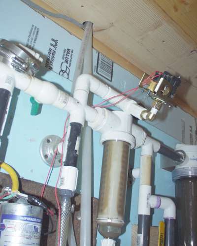

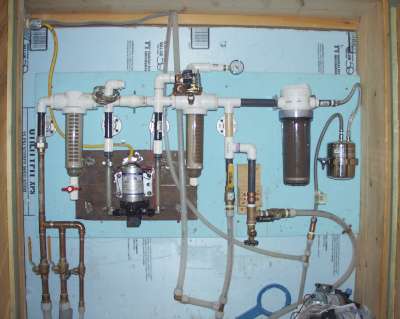

    Greetings!
    My wife, Nicole, and I live at the Greater World Earthship subdivision near Taos, New Mexico. All the homes in this 630 acre subdivision are completely off the grid. The homes heat and cool themselves and provide water, hot water, electricity and on-site, contained, sewage treatment systems using nothing but the sunshine and rainfall that strikes the home (www.greaterworld.org).
    We have 3,600 gallons of cistern storage for the rain that lands on our metal roof that is pressurized with a Shurflo 24Vdc pump. Since the pressure switch on the Shurflo failed (open circuit, thank God), I added a Square D Pumptrol 30/50 switch which works very nicely (very quick and clean cutoff when the pressure hits 50psi). The only problem is the washing machine now triggers an oscillation.
    When the solenoid valve in the washing machine opens or closes (I'm not sure which or both) AND the standing pressure of the system is somewhat close to the cut-in pressure of about 30 PSI, the Pumptrol will cut-in, cut-off, cut-in, cut-off ad nauseum with a period of about 1 second until I open a valve or unplug the Shurflo 24V pump.
    I installed a Sioux Chief 600H Mini-Rester water hammer arrestor on both the hot and cold water feeds to the washing machine. This did not solve the problem!?!

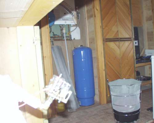

    While troubleshooting previous problems, I had drained the pressure tank and the pre-charge was about 25psi (using a tire pressure gauge that is not the most accurate in the world). Pumptrol cut-in is about 30psi according to the water pressure gauge on the system.
    The Pumptrol switch is about 1 foot away from the Shurflo pump. The pressure tank is about 8 feet away from the Pumptrol switch with the water line running just underneath the brick floor. I'm not sure how long the line is from the washing machine to the pressure switch since I wasn't the one to install it, but I believe they went up into the ceiling and then back down for some of the pipe runs (they used Wirsbo Pex).
    Where is the best place for the pressure switch? Should it be by the pressure tank?
    I have a third Mini-Restor 600H. Should I install this next to the Pumptrol?
    Now we also have a Solahart 302 Black Chrome 80 gallon solar hot water heater on the roof (the 80 gallon tank is on the roof). The cold water feed to the Solahart is about 15 feet long from the floor to the tank on roof. Could that be a problem somehow?
    I also tried increasing the pressure difference between cut-in and cut-off but it didn't seem to help. I'm pretty much baffled at this point! I know it has to do with the momentum of water and sudden changes in water flow but what is the simplest solution?
    Thanks so much in advance for any suggestions!

    I can't quite figure out the relationship between the pressure switch, tank, pump, filters, and washing machine tap. Can you post a schematic?
    I suspect that the problem might be related to pressure drop in the filters. If the washing machine solenoid causes a flow through a filter in a way that will affect the pressure at the switch, then it could cause the switch to actuate.
    I like to see the pressure switch at the tank. The switch then "sees" the pressure in the tank which can't change quickly because of the air cushion.
    The problem will be made worse if your filters are near end-of-life and the pump is pumping to the pressure tank through the filters.
    When you put the pressure switch at the tank, you will have to take great care with the filter changes. I believe that your pump is a positive displacement pump.
    One very nice solution with filters is to put a pressure tank at the pump, controlled by the pressure switch, and another tank after the filters. That way your pump gets an adequate cycle and the filters can work while the pump is off. Also, the filters have smaller effect on the delivered pressure than they would if they are after the tank. You will be able to get more life out of the filters. The tank at the pump should be sized for cycle time and the second is sized fou your pressurized storage needs.

    Hi Guys,
    Sorry I was so late in replying! I thought I was supposed to get an email when someone responded to my question. Good thing I logged in today!
    Here is a schematic of the water system:

    I suspected that the pressure switch should be over by the pressure tank, but I really like the idea of two pressure tanks. How big should the tank next to the pump be? 1 gallon, 10 gallon, 100 gallons?
    I understand your concern about the filters now. Having the pressure switch by the tank could blow out the pump if the resistance is high enough in the filters!

    I think I figured out the problem! The 500 mesh spindown filter was clogged.
    It looks like the negative water hammer pressure transient turns on the pump and then the combination of the water hammer positive pressure transient and the positive back pressure from the 500 mesh filter was enough to turn the pump off.
    Then, the sudden on/off cycling of the water pump sends positive pressure pulse and the subsequent pressure drop via water hammer effect switches it back on again ad infinitum.
    But, if the 500 mesh filter is clean, then the only the hammer positive hits the pressure switch which, evidently, is not enough to shut off the pump and the transient dissipates.
    Also, the clogged filter tricks the pressure switch into turning off too early so the pressure tank never gets up to the desired 50 psi which makes it all the more susceptible to turning on due to a negative transient. If the tank is at 50 psi and a negative transient causes a 15psi drop, it is not enough to trip the pressure switch with a 30 psi kick on.
