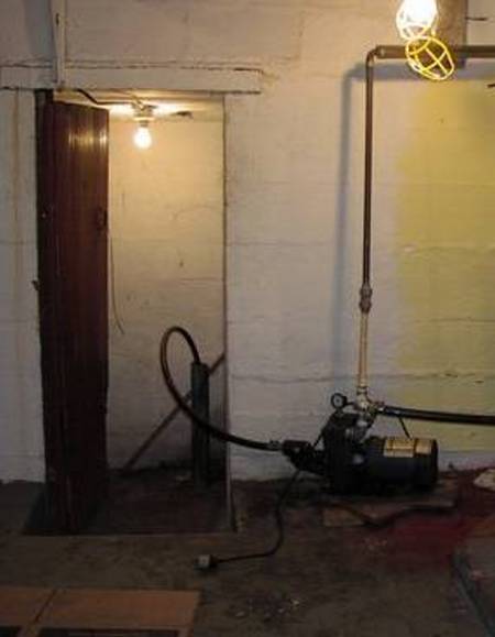

    As I last posted,I did get the foreclosed/winterized house shallow well jet pump working (numerous problems but mainly plugged nozzle).
    I'd like to feel I can at least wash my hands & maybe dishes if I use soap & bleach water.?????????????
    Due to lack of time because I am concentrating on getting my former house ready to be a rental, I am not spending any more time yet on this house I just moved into...I guess you could say I am morelike "camping out" in it.
    I am still pail flushing the remaining toilet & have not even turned on about 1/2 of the fixtures. I do have cold water at kitchen sink. Have not even tried the water heater yet. (I shower at my Mom's or old house).
    Question: What the odds that the 35' open casing well is UNSAFE for even washing hands & dishes?
    Condition: Looks mainly clear w/ some rust that settles & visible black manganeisum (sp?). Is there a quick, easy test I can do to check. I am not expecting it to be potable yet.
    I will not drink it til I later do a state lab test that verifies it is potable. But do you think I can at least wash my hands/dishes? It is getting to be a pain to drag my few dirty dishes around & wash hands from hose in backyard running from my Mom's.

    Pam, you've lived in the city too long. That well water won't hurt your hands. I would be more concerned about the city water they keep adding chemicals too than I would well water from 35 feet down.

    Assuming no chlorine in the water. As long as you don't have open sores or cuts the water can't harm you unless you bathe in it; showering should be fine. But you already shocked the well, and as long as you've run off the water from the well, you should be fine for everything but drinking/cooking with it but... A water test only tells you the quality of the sample of water that was tested, not future water quality.
    Your well may need to breath, so you may not be able to seal it and still get water out of it, especially with a shallow well single line jet pump.

    That would be a well seal. That looks like a three inch well, but could be a 4". After chlroinating and installing the well seal, you should be good to go.
    I can check your water for hardness, iron and PH. But for bacteria nitrates etc. you will have to send it to a lab.
    I'll PM you with the address.
