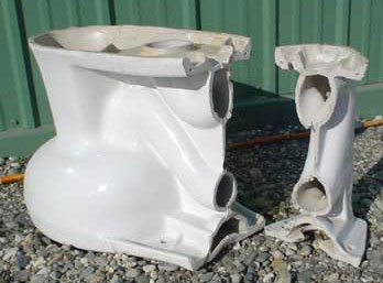

    a few of the 'problem units' cut in half (with a diamond saw)
    Briggs Vacuity (Even CR had little good to say a few years later.
    The Titan was roughly copied from the Drake, but without quality control or the same manufacturing expertise.
