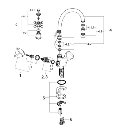

I have a number of Grohe mdl. # 31 054 faucets on my boat.
I need to replace some cartridges but for the life of me can't figure out how to remove those handles. :confused:
What's the secret?
From the parts breakdown, it lists the handle as a complete assembly, and then the subcomponents, one of which is center cap. Most of these have a cap that pops off to expose the screw which holds things together. It appears that yours is fairly standard in that manner. See if you can find a seam between the top of the handle and the rest of it. Being careful to avoid scratching things up, pry the cap off. You should see the screw, which will allow the rest of the handle to be removed. Should be easy from there.

There is no sign of a screw cap/cover on these handles Jim. Appears to be one solid chromed piece of metal.
I have all the original documention that came with these faucets including the installation instructions and parts list. No mention anywhere on how to remove the handles to get at the cartridges.
Anyone else know?
The part I mentioned is for a different set of handles, the cross. Should have looked closer.
Humm, maybe it is just a press fit, then the guts unscrew. You might have to wait until you can call them on Monday to be sure.

Yeah, a pressed fit is what I'm afraid of.
They cannot be pulled off by hand, that I know. And I don't want to try the tapered shim stock/hammer routine until I know for sure how those parts separate.
I see these faucets frequently, both on boats and in home bar sinks so I know there are plumbers out there who have dealt with this before.

They can usually be pulled off by hand if you sort of rock them while pulling. Otherwise wrap them with tape and then pull them off with a pair of Channel lock pliers.

I have worked on dozens of these. They do absolutely pull off. It takes muscle and grip; and watch out for what may be in the way of your elbow when the handle gives, cause it only gives with lots of force and you don't want to smack into anything.

Thanks guys, applying more muscle it will be. Given location and proximity to side cabinets I may end up removing the entire faucet assembly first to get enough leverage.

The part which the handle fits onto is plastic (semi-hard polypropelyene) so there is no bond whatsoever, just detents which fit snugly.

For that type of handle, you pull the metal handle off, and then you will see the attaching screw.

I just worked on some of those blessed handles yesterday. Brute strength is indeed the answer.
There is no way to use a puller, nor a place to jam in a wedge or two behind the handle.
I gave up on my first attempt, and the client decided to just live with the slow drip from the
faucet for quite some time. I went back later (with an entire replacement faucet at hand) and really
hauled on it, which did the trick. Be WARNED that if you forget to install the little (special) brass screw
holding on the splined plastic sleeve to the cartridge before you put the handle on, the plastic sleeve
will snap into the handle with it's death grip, but won't securely hold the handle on to the faucet.
I had to destructively attack the sleeve with an assortment of drill bits to get it out.
