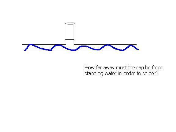

I know by reading and by experience that there can be NO water near the join when trying to solder.
But that leads me to wonder how close water CAN be to the join? e.g. if I have 1/2" copper running horizontally and there is a T installed which copper piece running up vertically from the T.... If I want to solder a cap onto that vertical copper (or unsolder an existing cap), how far away must the cap be from the 1/2" horizontal pipe that may have water? I would think the heat would make the standing water boil and thus jump up to the join area, thus making soldering impossible? Or is it fine as long as no water is TOUCHING the join area?
Hopefully my attachment (2nd grade drawing using Paint) helps explain what I mean.
I would try to drain all water but that's not always possible in this type of situation.
Thanks,

In your drawing the water would be far enough away to permit the soldering, but the air trapped between the cap and water would be expanding as it got hot and would probably either blow the cap off or blow though the solder creating a pinhole leak.
OK.. assume the water level in that 1/2" horizontal pipe is only half high.. in other words only half the pipe is filled b/c I was able to drain much of it.
Would the air still be an issue? I would think not because there would now be an air passage in the horizontal pipe. Agree?
Cass
5,947
The air will expand and cause a problem no matter how low the water is.
There must be an open path to the atmosphere some where in the line in order to not build pressure.
You could solder a valve on instead of a cap then close the valve when you were done or solder on a male adapter and screw on a brass cap when you are done.

I respectfully disagree.
1/2 water and 1/2 air in the pipe is fine.
A little water in the line away from the soldered joint is actually preferable. Water is an excellent heat sink (better than air) in that it requires more energy to heat than air.
Further, as long as there are no sensitive joints/valves within 4-5 feet, you don't even need the opposite end to be open to the air. The copper and water will conduct the heat through the pipe sufficiently. Test this yourself by wrapping a wet rag around the pipe 5 feet away from the joint and soldering the cap. If the rag starts to sizzle and steam, it is getting hot. (Actually, the presence of a wet rag is also a good thing, bkz it'll conduct heat away from the pipe better than the atmosphere will.)
Caveat: I'm an engineer, but not a plumber. The only emprical evidence I have for this 'theory' is my own experience. I've soldered a closed cap onto a sealed line with 10 feet in between the cap and a ball valve. The copper pipe more than 5-6 feet away from the cap was cold to the touch (which means it had NO hot air in it).

I'll give it a shot. I actually read in a book that such stub ups were often installed and capped in an effort to have air in the system which would reduce noise from the pipes. Sound about right? I think it's in one of my Black and Decker Plumbing how-to books.
Another reason I asked was (cap aside), if I was to try to install a shut off valve (replace the cap with a ball valve in my drawing) close to water, would I have problems with soldering...? That is likely what I will be doing.
Thus, is there a distance in inches or volume of pipe that water needs to be away from the join?

Well, it all boils down to the distance. If that riser was 3 or 4 inches, you might get it to solder before the air in the riser heats up enough to cause problems. If it is closer, the water might even boil.
As a practical matter, it seems like there must be an open end to the horizontal pipe. Obviously it is not pressurized, so if this is just a residential situation, we would always open a tap somewhere so that line would not be a closed line.
Think about a pipe freeze machine or a JetSweat. They are blocking water only 6 to 8 inches away.

If you solder a shut-off valve, you'll be ok. Just make sure the valve is in the open position, bkz the heat can damage the gasketing device easier than it can a copper cap. It doesn't matter how close the thing is to the water. As long as it's not touching or flowing through the soldered joint. I'd be more worried about harming the tee joint on the stub. To that end, wrap it with wet rag (I know, I'm a broken record).
IMHO, I'd put a valve instead of a cap anyway. The reason to stub like that is bkz you're eventually gonna put something there. When that day comes, you gotta drain the main line to solder the extension. With a valve, you don't have to do that. Put in a threaded valve so your 'extension' can be screwed in and any downstream soldering will be a safe distance from the valve.
As for the stub acting as a hammer arrester. That's not a great solution. The 'chamber' will only arrest the water pressure until it fills with water itself. This can happen in a few days. Once it becomes logged with h2o, you have to drain the system and 'recharge' it. Bad. The only thing a stub will do for you is to provide a convenient place to put a specially designed arrester in place. That thing is a shock absorber that doesn't get logged with water and keeps working.
