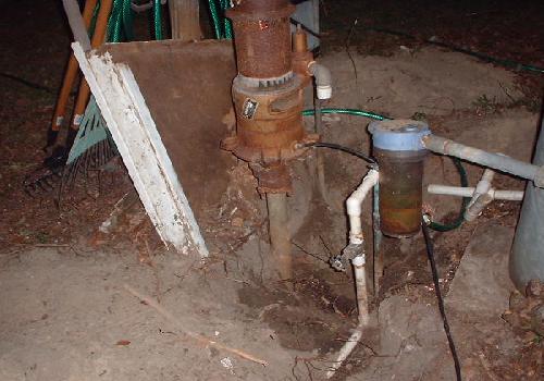

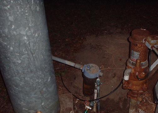

    Here is a pic. of the system. sorry its kind of dark, I'm new to this digital stuff. What your looking at is the rusty pump assembly with just the one 2-3 inch pipe going into the ground. I dug down to be sure there wasnt any kind of well cap but didnt find one. The breaker box is in front with no power to assure safety.The filter and tank are no longer connected the piping as you can see is in pieces. What isnt very visible is the city water line comes in via a 1 1/2 pvc pipe then 90 degrees up and connects with the copper pipe leading to the house. there is a spiccet with a green garden hose on it. Now based on this can I disconnect the pump and install a hand pump? Does this look like a system I can dismantle and put a hand pump on?

    The configuration of the pump, and the existence of the regulator on the discharge, suggest that it may a deep well jet. If that is the case, then there is another pipe inside the pipe you see.
    If you disconnect the outside fittings and try to lift the pump, you will either find, or not find, another pipe inside. If there is another pipe inside, then it is connected as a deep well pump and you will have to pull that internal pipe. That is probably not an easy job.
    If the pump come free with no additional pipe, it is a shallow well installation.
    If it is a deep well jet, then you probably can't use a shallow well "pitcher pump" to get water out of the well. It all depends on the depth to water.

    The picture seems to show a bolted joint. That is where I would start. If you disconnect that, see if you can move the pump. You might need a come-along or hoist to lift it if there is an internal pipe below the pump.
