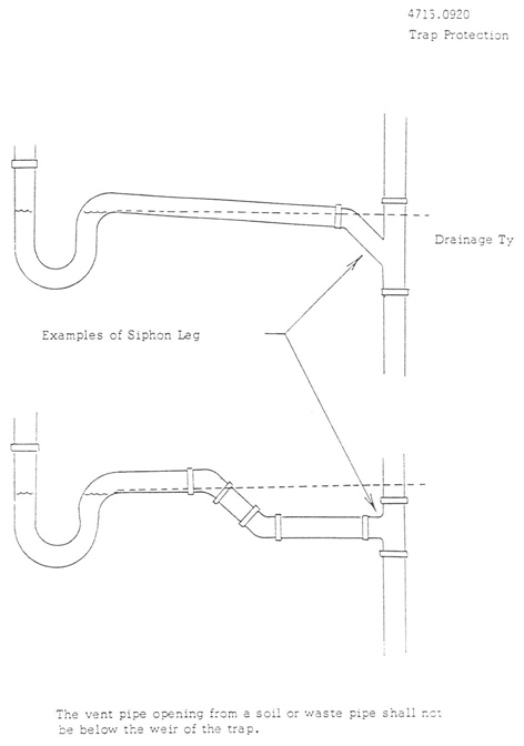

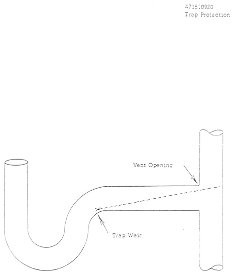

    The wet vent is the vertical distance between the two tees.
    Although the following images only refer to a single fixture installation, they do show why wye's are not acceptable for fixture venting, at least when vertical.
    Last edited by dubldare; 02-07-2006 at 04:21 PM. Reason: Images copyright Ralph Lichliter/MAPHCC

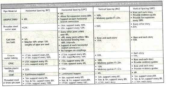

    Wondering if, per code, a vent stack for a multistoried building is to be supported at specified increments? Seems to me is has to? Perhaps every 10 feet or at the top of each floor? I'm asking, again, prior to cutting my lavs steel vent stack, in the middle of the third floor of my four story building.
    I would imagine that for multi story buildings a number of pipes would need to be plumbed/fastened together to form the vent stack. Based on this assumption, I would tend to think that this piping would, at a minimum fasten, together at flanges which are supported by the buildings framing?
    Please let me know if you you can help me by answering this support question.

    From what I've researched it appears that per IRC (T2424.1 & T2605.1) vertical spacing for threaded steel water pipe is 10 ft.
    Additionally, per UPC (T3-2) supports should be every other story or every 25 ft.
    Am I reading this correctly?
    Please advise

    There should be a riser clamp resting on the bottom plate of each floor.
    In the real world you don't know that! Install your own clamp below your top plate and use additional hardware to attach to both side studs or leged into top plate . has to be SOLID good luck
