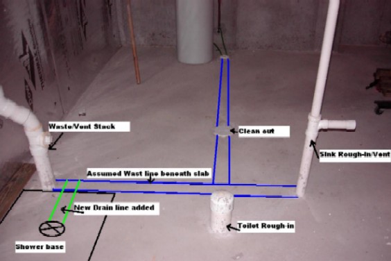

Thanks again! OK, you talked me into breaking up the Concrete. Here is a picture I attached just the give a lay out of what I'm trying to do. On the picture you can see where I plan to trench into the existing Clean-out beneath the c-crete. As far as venting I assumed the Clean-Out line is already vented thru the house plus the venting on the sink rough-in is connecting up with the clean-out line below the C-crete. Please let me know if this is the best approach.

Sorry, I'm a first timer. I didn't word my plan correctly. I plan to tie into the waste line drain beneath the concrete slab not the clean out. I'm assuming the waste line drain is vented along with the sink rough-in that is connecting beneath the slab also. On the picture there is a pipe which is coming from my first floor and going into the concrete. The (T) that comes off of it I'm hoping is for the sink.

To me, venting was the most difficult thing to grasp. I would originally have thought what you think, but I've been given advice from experts (namely, HJ and Gary) and have read everywhere that every single fixture needs to be individually vented. If you don't do this, there are many reasons why the shower trap may fail to work properly. In your proposed configuration, I'd speculate that the toilet draining past the shower branch could pull water out of the trap, or that if the shower is far enough from the drain, draining water from the shower could siphon out its trap.
I assume you'll build a wall between the shower and the drain, so that'd be a convenient place to put the shower vent. That vent line can join the sink or toilet or main vent line along the ceiling of the basement. You don't have to run a separate, dedicated vent out the roof - just a separate branch to the fixture.

Thanks again for advice. As far as the toilet vent I don't know where that is. What you see in the picture is pretty much the rough-ins for 1/2 bath (sink and toilet. I don't know if the plumber left of the toilet vent by mistake during the initial contruction. Or there's a possibilty it could connect up with sink vent beneath the slab. I'm sure the plumber could have not forgotten to add toilet vent on????

There are too many possibilities as to how the piping could be arranged under the floor to try to tell you how to do it, until you actually open the floor and see where, and which way, the drains run. That vertical pipe next to your new shower location could be the drain from the upstairs, in which case your drain would need a new vent connection, or it could be the vent for the basement toilet. Not likely, but if it is, then your location to connect the shower drain would have to be reconsidered.

If your house is new - like mine - the township construction office should have the plumbing diagrams. At the very least, they'll have the name of the plumber who installed it. Before you do a lot of exploratory destruction, I'd check there for a possibly easy answer.
