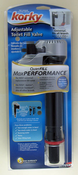

    Default TOTO Ultra Max
    I installed a TOTO Ultra Max a while back, and am havind a water hammer issue. It seems that the fill value is "slamming" shut rather than easing shut. Can this be adjusted?
  9. #159
    12,597
    It depends on the fill valve that you have. Some of their fill valves shut off quicker.
    You may want to look at the Korky MaxPerformance valve if you want a softer shutoff.
    Sometimes they come with the Korky style, and sometimes not.
    I've seen some customers where there toilets had been leaking so long, that when you replaced them and tightened up the system, they found out they had water hammer. A system with constant leaking; you never notice hammer.
  10. #160
    DIY Junior Member GeorgeCT's Avatar
    Apr 2011
    23

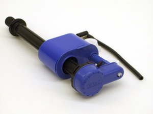

    To Viking and Terry...
    It's just been over a year since I installed my TOTO Ultramax (and love it), but the fill valve was always temperamental.
    It always would make a squeak or chirp noise when water started or stopped. Though I never had water hammer.
    I've cleaned and reseated the washer in the cap assembly which initially helped with a leak that allowed the water to trickle out of the fill valve after filling.
    Recently I noticed that the original valve was letting water fill the tank ever so slowly after shut off.
    You couldn't even hear it but noticed the water spot was higher than normal and when I opened the tank lid the water line was up to the overflow tube (even though the stopping point was a half inch below it). It usually took over 12 hours of non use for the water to over fill.
    I was going to purchase the Korky 528T as a replacement.
    Instead I tried the Max Performance by Korky purchased from Lowe's and it works perfectly.
    You can adjust how much water flows into the overflow tube for bowl refilling for the perfect water spot depth.
    It starts and stops water flow a bit slower (or softer) so I don't hear that squeak or chirp noise anymore (from sudden starting/stopping of water flow).
    It does fill a tiny bit slower (by about five seconds) compared to the original fill valve which only took 20 seconds to fill.
    So 25 seconds to refill is not a deal breaker.
    I highly recommend the Korky MaxPerformance.
    (Pictured is the original fill valve and the MaxPerformance fill valve as a comparison).

    GeorgeCT: The symptoms you experienced from the Voreto valve in your picture are exactly why I ripped it out and put in a Korky in my Drake. The 528MP is perfect for our Totos. As you may have read elsewhere on this forum, Toto is now selling basically the 528MP as its Universal Replacement fill valve. The packaging is different and the instructions are more precise, but it's basically the same thing. I'm glad it worked out for you.
