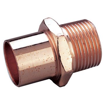

I am just about done remodelong my shower. I have a couple of Hansgrohe body sprays. They required 1/2 inch nipples recessed 3/8 inch from the finished wall. after tiling, they are recesses slightly more that 3/8".
The body sprays screw on and tight to the wall, but they don't seem tight enough onto the nipple, so I am worried about leaking.
I know I could have galvanized pipe cut to length, but how do I get brass nipples of the appropriate length. These Hansgrohe sprays don't seem to have any wiggle room, and another 1/2 inch would be too long.
Thanks,
Ron

Home Depot and Lowe's have some (small selection) brass nipples, just for a starting point. They might have the length you need. To get something custom cut and threaded, go in person to a plumbing supply shop. If they can't do it for you on the spot, they will probably be able to refer you. Make sure to put on your best "I'm just a simple homeowner and need some help from the pros" look. Chances are they will take pity on you and help.
It's not difficult, but you need the right threading tools to do it cleanly. I did a summer job as a pipefitter and an electrician helper, wish I had all the tools I used back then. ;)

I haven't seen your rough plumbing, or the body sprays, but I would bet you can fashion something out of copper. Use 2 male adapters with a short length of pipe in between. Fire up the torch and go to town! The limitation will be the flange length on the adapters.
Take two of these puppies, with a short piece of pipe, and you're good to go.

If you use that nipple you can gain if you wrap a little more teflon tape on the threads. The nipple will tighten up a little sooner. You may have to undo it and add a little more tape dope .
You have to be the judge.
I'd say If you get 3 or 31/2 turns on each end of that nipple that you should be ok. A little teflon compound on top of the tape dope couldn't hurt either.
The other thought is can you gain a little also by adjusting something from the backside of that wall?

I was at Lowe's today, they have brass nipples in 2" and 2 1/2", in 3/8" and 1/2" pipe. plumber1 has a good idea in that you may be able to get away with not running the threads down hard on both ends of the nipple. I like to use some teflon paste *and* teflon tape in such situations. The 'ole belt and suspenders philosophy.
