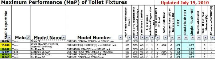

    Question Toto Drake and Latest MaP ratings?
    I see here a lot of testimonials for the Toto Drakes, and that's definitely goodness. Nothing like real world experience.
    One thing I noticed, the latest MaP ratings, showed the Drakes as topping out at 800 (which is also the high for all the Totos), as versus the 1000 for some of the other toilets.
    http://www.cuwcc.org/WorkArea/linkit...d&ItemID=14058
    I've tried to net it down more clearly, from the spreadsheet, so you can see the MaP ratings, attached below.
    Now, 800 is still a pretty decent rating, and it says really nothing about bowl cleaning action/capability, one of the fortes of the Drakes, and I suppose there might be a trade-off between bowl cleaning and raw flushing ability/capacity. Any thoughts?

    Hi PW,
    My thoughts on this is actually a mix of information...
    While the MaP Report is a great resource it is only part of what makes a toilet good.
    If you read the entire report you will see that the reason they don't test above 1,000 grams per flush and that the reason the WaterSense certification threshold was set to 350 grams per flush is that 350 grams is larger than the fecal size for the 99th percentile of the male population.
    Toilets use 1.6 gallons per flush, and new ones use 1.28 gallons per flush...
    There is even one that uses 0.8 gallons per flush...
    Mentioned in the MaP report is bowl wash. The higher flush ratings often come at the expense of bowl wash...
    This bowl wash is what leaves the bowl clean after flushing...
    What good is a toilet than needs brushing and a 2nd flush after after every use?
    Yes some are that bad!

    Some of the very early MaP testing had the Toto Ultimate MS854114 at 325 grams.
    I had one installed in my home for two years, and installed four in my church.
    They were flawless.
    I then installed a Kohler Cimarron with double the MaP rating, and it was plugged weekly.
    There was no bowl rinse at the back of the bowl either.
    There is only so much you learn from a test done in just one way.
    Since the MaP has started wrapping the paste in plastic, so the can reuse the media over and over again, is that the test numbers went way up.
    It didn't mean the bowls were better, just that the test method had changed from lightweight sticky media to heavier slippery media.
    Of course the numbers go better.
    I've found that in real use, anything with a 500 MaP is extremely good. And yes, bowl wash is very important, and no, the MaP doesn't test for:
