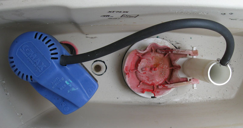

    Recently my wife put a Clorox tablet cleaner in the tank and over the period of a week or so disfigured the flapper so much it wouldn’t stop the water. I replaced the flapper and it’s fine, but have you ever heard of that sort of product doing so much damage to a flapper? It felt like sticky, soft candy.
    D. Evans
    Seattle WA
  10. #160
    14,209
    I bought a Toto from you a few years back – works great. 2004
    Clorox and Rubber don't mix well.
    Chlorine will void the warranty for all manufacturers.
    Lowes carries the replacement flappers.
    2004, that was a while ago.
