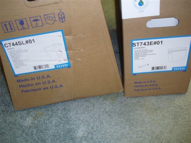

    Default Purchase Experience Toto Drake CST744SL
    After reading this forum, I decided on a Drake Elongated ADA toilet...CST744SL. I'm in NC. I went to the TotoUSA website and found the nearest supplier and called them. They said they had the CST744SL and gave me a price. I drove to the supplier and picked it up. When I got home, the tank said Eco on it....see attached picture. I called the supplier, she said that she could no longer get the 1.6 GPF Drake tank and by law she had to sell the Eco tank. She assured me that all was well and I called my plumber who installed it. The combination flushed very well. I noticed that the water didn't fill up to the place in the bowl where it looked like it should. Also the tank moved on the bowl...plumber error I believe. The bowl said 1.6 GPF; the tank said 1.28 GPF. I emailed TOTOUSA Support...they promptly replied that the combination was wrong and that I should have a ST743S tank. I called the supplier who said she would swap the Eco tank with one in the show room. She had someone check it out before I swapped the tank. When I got home to install it, it was missing hardware to connect the tank to the bowl. It was missing the hose and clip that goes from the Gmax fresh water inlet valve to the downspout. I bought 2 sets of hardware to get the identical bolt setup as in the installation instructions and a corky valve device to get the correct hose and clip. I finished the installation myself...the water in the bowl is correct...the unit flushes like none other. The tank fits tightly on the bowl. I love it...If you don't suceed at first try again! From all of the excitement above I learned that one should check and double check before you take anything off of the loading dock. If you get a Drake you should end up with 2 boxes a bowl with C744SL and a ST743S tank. Since I had half an Eco for a week, I found that the Eco really works well, and that will be my next purchase.
    Question: Should water and air bubbles come out of the base of the GMax/Korky style inlet valve...(all inside the tank)?

    Quote Originally Posted by hudson View Post
    Yes the water does come out of the bottom of the Korky and it usually will have bubbles as well.
    Sorry to hear everthing got mixed up at the supplier. Usually things work out better than that.
    I like those boxes that say made in USA...

    With the Drake, you can use the E bowl with either the S tank or E tank.
    I haven't seen an S bowl in some time now.
    When they pull fixtures out of a showroom, any number of things could be robbed. Sometimes, knowing they will never see water, they barely assemble them.

    Default One last Question
    Thanks for the helpful replies!
    When you flush the Toto Drake...and do not hold down the lever, only about half of the water goes out of the tank.
    I think that's by design, but I'm not sure.
  15. #135
    Dec 2007
    7,460
    Yes that is by design.
