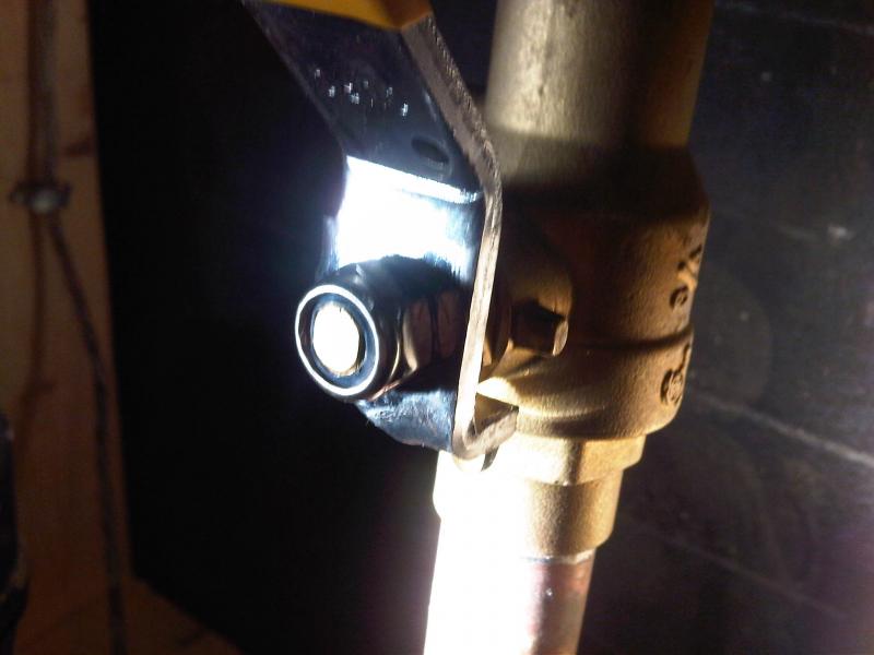

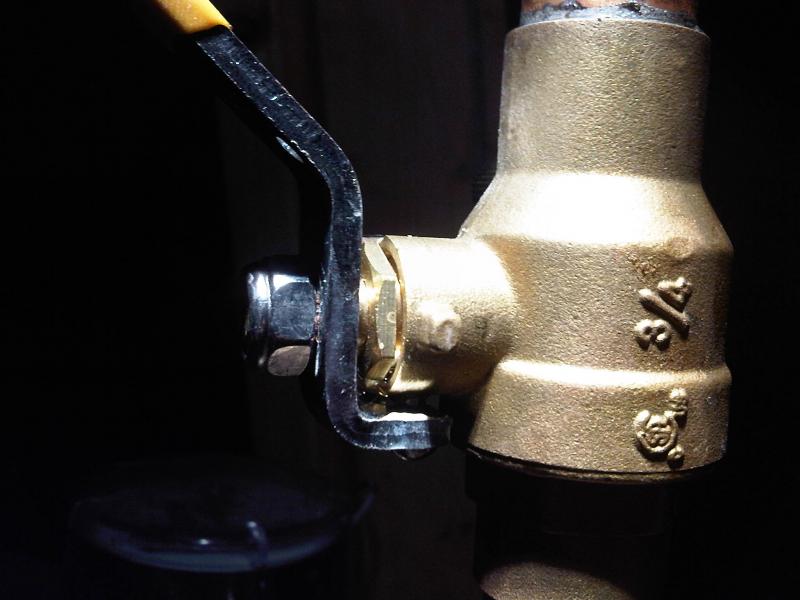

    I found this forum by searching for leaking ball valve. I"m desperate to fix this valve instead of replacing it if possible. I just spent a long time soldering the joints all around it and add the fact that it is my main shut off for my house now I would have to call the city to turn the water off again to do the work over.
    So if this stem behind the handle on the valve is indeed adjustable and could be the solution to this leak can someone please help me figure out how to actually adjust it. It may seem obvious to most but not me. All my channel lock pliers are too big to get in behind the actual handle.
    HELPName:  Ottawa-20120914-00923.jpg

    Take the nut off, then the handle will slide off, then you'll have access. Use a wrench (preferably) rather than pliers.

    Rmontyw:
    Further to what Jadnashua said:
    1. Hold the handle steady as you unscrew the locknut holding the handle on. Otherwise the handle may turn with the wrench.
    2. Only tighten the packing nut under the handle enough so that you can open and close the valve without it leaking. Tightening it more than that simply causes the packing material to wear down faster than necessary.
    3. The ball valve handle will look something like this:
    Note that the hole in the handle for the ball valve stem isn't round, but a slot. The end of the ball valve's stem will be the same shape, and that can make it easy to misthread the lock nut when putting the handle back on.
    (If you have trouble getting the lock nut back on and you do end up screwing up the thread on the end of the stem, don't sweat it. Just hang the handle to the water supply pipe near that valve with a piece of wire or something and use the handle to open and close the valve when necessary.)
    4. The valve is open when the handle is parallel to the pipe and closed when the handle is perpendicular to the pipe.
    5. Always ensure ball valves are OPEN when soldering them in, and give them plenty of time to cool down before operating the valve.
