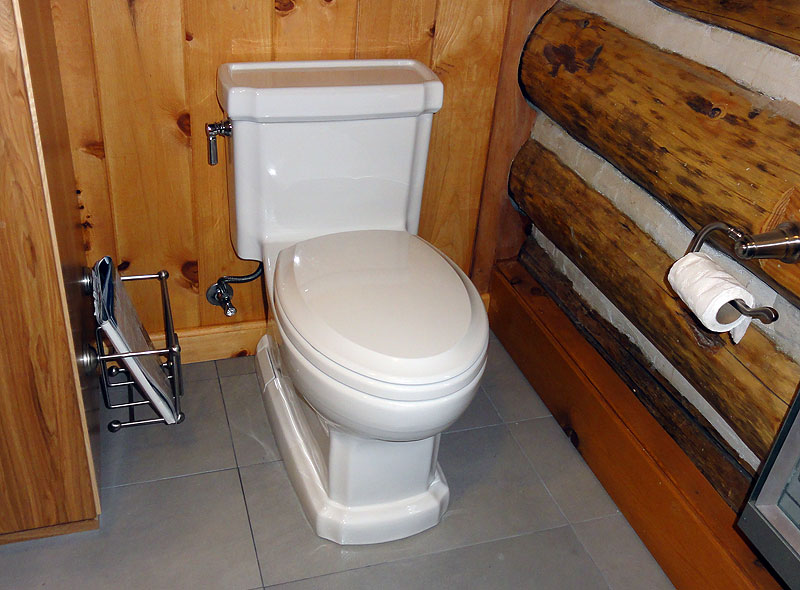

  10. #85
    12,416
    This looks nice in a log cabin.
    hj, this also meets the ADA requirements.
