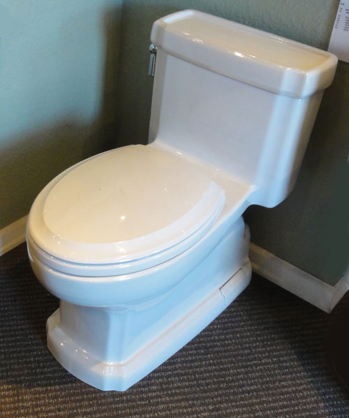

    Added new picture.
    I carry these in Anchorage, Bothell, Seattle, Los Angeles,
    TOTO Guinevere with seat.

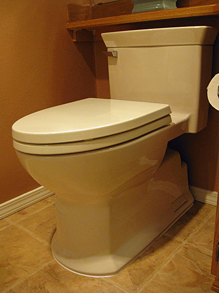

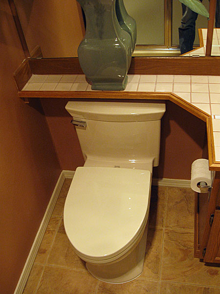

    Here is an installation of a Toto Soiree in bone, it allows the use of a high bowl, and it fits under a banjo top. That's a tough combination to fit. A tall bowl, and a short counter over the top of the tank.
    Toto Soiree in Bone, Issaquah WA
    The caulking will turn clear when dry.

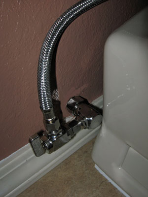

    If the shutoff is 6" to the left of center you can use the old shutoff, this one was 5" to the left of center, which meant using a Dahl valve designed for the Toto skirted toilets. It's much shorter from the wall.
