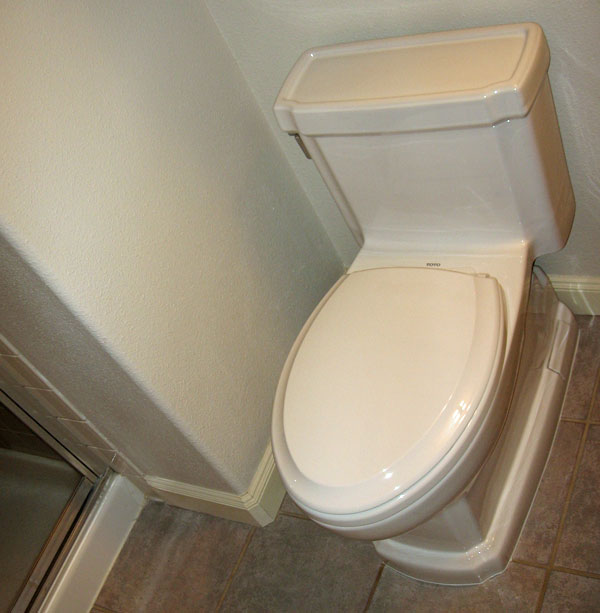

I put a Toto Guinevere into my bathroom (the only one functioning at the moment all the rest are gutted) 2 months ago, and I have had no problems with it.

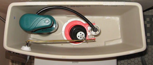

Looking inside the tank of the Toto Soiree

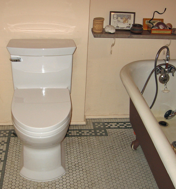

A Soiree in an older home in the Ravenna neighborhood.
The TOTO Guinevere
These older homes have 14" rough-ins.
Since the Toto with skirted base lets me change the rough-in, I can still pull the bowl back closer to the wall.
I can install these at 10", 12" or 14"

Terry, I have 5 Guinevere toilets in my new home. I had a problem where the flapper would not close because the handle, which is normally in the "six O'clock" position would stick in the "3 O'clock" position. This only seemed to happen with the toilets in my 6-year old twins bathrooms. It seems that when they went to flush the toilets they would pull the flush handle not too hard or too soft but just enough to get cause the copper rod to "wedge" against the nut holding the handle to the tank. It took me many tries before I was able to replicate the problem, because it was intermittent, but when I did, I called Toto and they sent me out new handles for all the toilets. Since the new handles were installed, the problem has gone away. Toto says that they never heard of this problem. Have you?
Also, one of the Guinevere toilets would periodically emit a "shrieking" noise when not being used. I fiddled with the float adjustment screw on the fill valve and it stopped the noise but it continues to do this randomly. When I started to research this problem I discovered that of the 5 toilets in the house, this is the only one that is a 1.28GPF model (Green Flush Valve w/white screw) while the others are 1.6GPF (Blue Flush Valve w/no screw). My question is, is there any difference between the 1.28 and 1.6 models besides the flush valves. Can I replace the Green valve with the blue?
Thanks - Great forum
The china is the same.
They change the fill valve to shut off a bit sooner.
And on some they weight down the flapper to drop quicker.
But, if you overfill the bowl a bit, the extra water finds it's way down the drain.
If the fill valve is making noise while idle, then you may have a leaking flapper.
Fix the flapper, and the noise will go away.
Those fill valves tend to give a little squeak when they shutoff.
Check the flapper for leaks.
The only other thing I can think of is if your water pressure is too high, the weakest point in the system will leak...it could be that flush valve can't handle that high pressure. Have you ever checked yours? You can buy a gauge at one of the big box or plumbing supply houses for about $10 with a max tattle-tale hand. Attach it and leave it on overnight and check the pressure periodically and then the max. If it exceeds 80psi anytime, you need a PRV and an expansion tank, or if you have them, one or the other is bad.

Terry, first, thanks very much for the suggestion to use the "blue" Korky flapper. This made a BIG difference in the flush volume and force. The water height in the tank was 6 3/4" which when flushed with the original "orange" Toto flapper would drop to about 3 1/2" in the tank before the flapper would fall and the tank would refill. After switching to the "blue" Korky flapper, the water height in the tank which was still 6 3/4" would then fall to about 2", meaning that an additional 1.5" of water would be used in the flush (whatever that equals in volume). An additional item that I wanted to mention is that the other difference between the 1.6 GPF and 1.28 GPF Toto Guinevere toilets is that the flush valve stand pipe/bowl filler pipe is about 1" taller in the 1.6 GPF toilet. Will I have any issues substituting the "blue" fill valve for the original green fill valve? I never really had an issue with the 1.28 GPF toilet and the blue flapper has made it that much better. I was prepared to put a 1.5" pvc coupling on the fill valve pipe which would provide about the same flush valve height as the 1.6 GPF toilet but it now works so well that I don't think this will be necessary.
