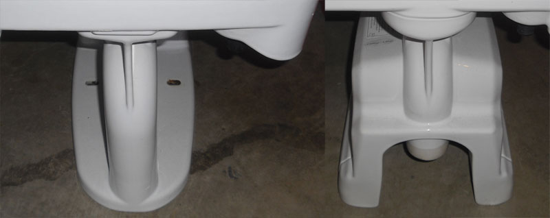

    Oops! Not a pleasant experience yesterday. First, the plumber sent out by my "Silver rated" Toto dealer couldn't figure out how to install the toilet. He got all the way to dropping the cone into the adapter and couldn't make it fit in. He said it wouldn't fit because there wasn't enough space to the wall and I needed to strip the tile off the wall. After he left (with a $155 check), and I got over my shock and removed the bottom 6 tiles, I tried to seat the toilet and found I was having the same problem. Then the answer came to me.... Press down. With a little pressure the cone slipped into the adapter as smooth as silk. The 2 hours I'd spent stripping tiles off a 40 year mortar bed was totally unnecessary. So, why am I still unhappy. Check out the video. I know these toilets are super flushers. What's wrong with mine? And what's with that pathetic gargling at the end of the flush. I know I'm missing something pretty obvious but, frankly, I'm exhausted and my brain just ain't functioning. Thanks in advance, guys...

    Pull the tank lid cover off and make sure that the refill tube from the fill valve is pointed down the overflow tube.
    This is what refills the bowl.
    If the bowl is not full at the beginning, then the flush from the tank only fills the bowl, it doesn't flush the bowl.
    I'm sorry that you installer was clueless.
    Yes, you install the adapter with wax, bolts and screws to the floor.
    And then you drop the bowl onto that. Most homeowners figure that out pretty easily.
    It's too bad that many plumbers don't read the instructions. The paperwork that comes with the toilet shows how much room is behind the tank with a standard 12" rough. You don't have to guess at this.
    At 12", you should have 3/4" behind the tank.
    The next step after "reading" that, is to use a "tape measure"
    The two tools your plumber should have used were
    "reading glasses"
    "tape measure"
    The rest is common sense.
    An adapter installed on tile using the green inserts and the screws that come in the Unifit Box.

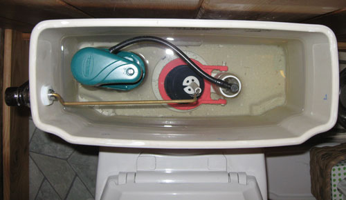

    Thank you Terry. Sorry for the vent, but as I said I was just tired. This is how he attached the refill tube. It isn't the overflow, but it does point down it. And as you see there is still no flush. Oh well... (p.s. It was the 10" adapter.)

    Owning a couple of similar Totos, what you are seeing is not normal. It looks like you probably have a drain line obstruction or, when they installed the adapter, they blocked part of the drain with the wax.

    I'm thinking so too Jim. There was wax oozing out all around the adapter. I never see that in Terry's pictures. We plan to call the company Monday.

    Arrrrrrgh! You're not going to believe this. I walked in this morning, gave it a pity flush and voila! Flushed perfectly. What did I do? Absolutely nothing! I have no idea what happened. It was a miracle... I have a self-healing toilet...

    It's possible that you have a partial drain line blockage, and that overnight, it drained down so there was plenty of room for the waste water to go. It sounds like it's not the toilet at all, and a drain line problem.
