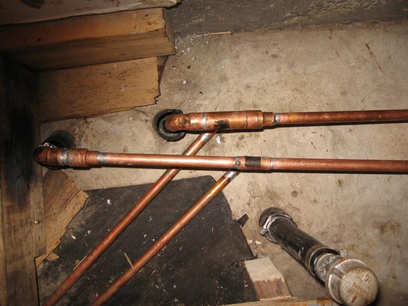

    The only big issue with having transitions between 1/2" to 3/4" and maybe back again is restrictions in the flow and those 3/4" sections will contain more water that has to be flushed out. How long are you running the water, and how big of a demand on the actual hot water are you asking for? Most tankless systems require at least 1/2gpm flow through them to turn on. WHen you ask for hot water at those other locations and then go look at the thing, has it turned on? One of the big complaints on tankless systems is just expecting warm water at something like a vanity may never trigger the thing to turn on - those faucets are flow restricted, and then unless you select nearly all hot, may never get enough flow to turn it on, and then, depending on how hot you've set the thing, it may be too hot or no hot at all. Often, once triggered to turn on, you can lower the flow some, but it takes a learning curve to figure out what you need to make it work. To me, it's not worth the aggravation and the (often) considerable increase in infrastructure to install one.

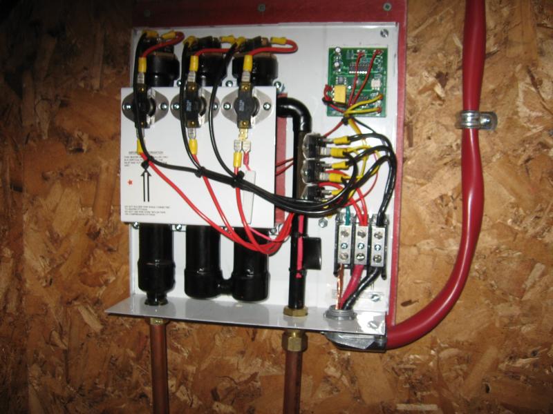

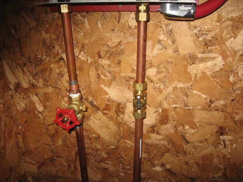

    So on the unit, cold ater in on right hand side, hot comes out on left side.
    Under unit, on right, on cold side, theres is a shut off valve. And on left, hot side a flow regulator.
    In other picture, pipes come out of concret foundation at 3/4", so lower pipe is cold, feeds small bathroom, with 1/2" pipes then continues to unit with 1/2" pipes. Top pipe comes from unit, supposed to be hot water, forks off to feed small bathroom with hot water, wich it does, abd then goes back to 3/4" pipe to feed the rest of the house, where at other bathroom and kitchen the pipes recude back to 1/2", but no hot water.

    Yes, sorry about that, it is a fully electrical unit.
    The breaker panel puts out 200amps 2 phase and the unit requires 60 amps 2 phase. I have a 70 amp breaker on the line feeding the unit with 4 guage wires.
    I also checked, while the unit is running, what its pulling and in all, unit pulls 60 to 62 amps total and at the 3 elements it pulls 20 to 21 amps each.

    I don't know how the controls on this heater work. Are each of the 3 elements pulling full current when you have the hot water faucet open in the kitchen?
    yes, 20 to 21 amps each, so about 60 to 62 total at line in.
