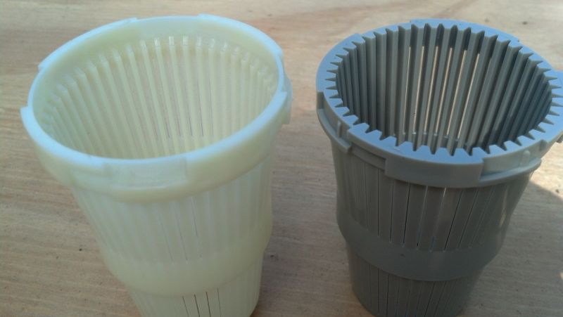

    Here are two screens: The one on the right is grey, ordered from softenerparts.com as Fleck p/n TDB1050-BS. The one on the left was bought from a local dealer, his internal p/n FILA0072, described as "Upper screen, fits Autotrol and Fleckenstein". Both have 45 ribs and roughly equivalent slot areas (within the limits of my measurment capability) of around 1.06 sq in. The only obvious differences are that the Fleck "base" is 0.286" thick and it locks in by turning counterclockwise; the natural one has a 0.487" thick base and locks by turning clockwise. Once locked in, I don't see any way to get it out without destroying it. The Fleck looks a little sturdier, but that may be an optical delusion.

    The Clack equipment is also different in the valves and heads. They have two locks in the valves that make removal very difficult. The Fleck has four slides, they also lock but the screens are usually removable. The Fleck to screen shown looks more like a knock off than a true Fleck. The real Fleck one is a lighter grey. I could be wrong due to the color differences in the picture/monitor, but... The Fleck original is stronger in my opinion than the Clack standard top screens. Clack makes the best heavy duty top screens on the market but they are very expensive. Name:  D1225-05-2T.jpg

    The Fleck to[p] screen shown looks more like a knock off than a true Fleck. The real Fleck one is a lighter grey. I could be wrong due to the color differences in the picture/monitor, but... The Fleck original is stronger in my opinion than the Clack standard top screens. Clack makes the best heavy duty top screens on the market but they are very expensive.
    Can you recommend a dealer somewhere who will sell me what I actually order? I've only seen one screen with a molded p/n in it, and it was a 1236 sold to me as a Fleck 40922. God knows what I'm getting if there's no identifying mark.

    The 1236 is a Clack screen, not the 40922.
